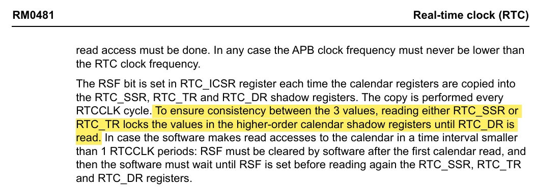

I have found a bug that stops updating the RTC_TR register. There is no problem with the RTC clock itself, it is ticking but the content of RTC_TR might in some specific use cases stop updating.
I use the latest STM32CubeH5 Firmware Package v1.5.0 for STM32H5.
The problem:
When only using the function HAL_RTC_GetTime(const RTC_HandleTypeDef *hrtc, RTC_TimeTypeDef *sTime, uint32_t Format), the time stored in sTime is not updated. I even printed the content of RTC->TR and it is stuck, not updating.
However, when I use it together with HAL_RTC_GetDate(), the RTC->TR is changing. When stop calling the HAL_RTC_GetDate(), the RTC->TR is stuck.
With following example code, in C, I narrowed it down that it relates to access of RTC_SSR register.

Call HAL_RTC_GetDate every time after you call HAL_RTC_GetTime. The time register is frozen until you read the date. This is intentional to keep time/date readings consistent.

With BYPSHAD=0 (which is default), you always have to read RTC->DR as the last register, after RTC->SSR and RTC->TR.
