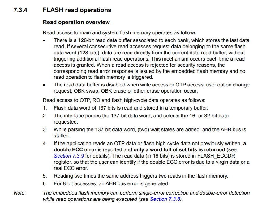

What is the correct way to read high cycle flash data.
When i read address 0x916800 i get a Hard fault. Clearing and writing the this address works fine.
With reading i have a problem. bank 2 has EDATA enabled for the last 2 pages.
Can you give me a code example for reading the memory correctly?

Dear @mahirmahota ,
You can look to our example here :
STM32CubeH5/Projects/NUCLEO-H563ZI/Examples/FLASH/FLASH_EDATA_EraseProgram/Src/main.c at main · STMicroelectronics/STM32CubeH5 · GitHub
You need to configure the MPU region with right address of EDATA

Also, have a look on our Reference Manual on the way, we read these Areas : OTP, RO and High Cycle Data - EDATA.
Hope it is helping.
