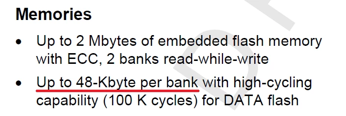

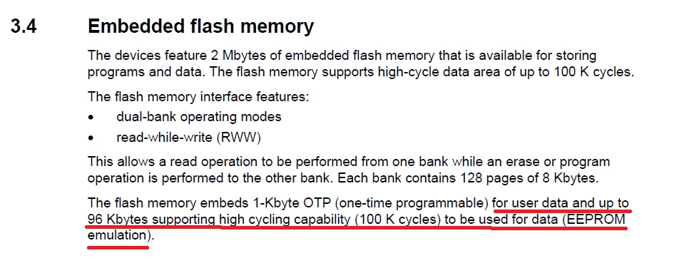

mƎALLEm
Feb 14, 2024 2:44 PM UTC
You didn't mention which H5 part number you're using.
But in the case of STM32H56x and STM32H573, there is a dedicated part from the flash which can be used for EEPROM emulation. 48KB per bank:

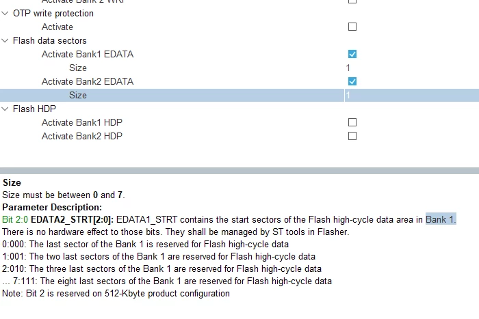

VictorGJAuthor
Feb 14, 2024 5:26 PM UTC
Thank you for your response robmilne, it has been very clarifying, it serves as a guide for me to develop my application. I see you have done a great job using Flash.
Thanks for your response SofLit, I am using the Nucleo-H563. Using MXCube, the detail of the description led me to confusion
