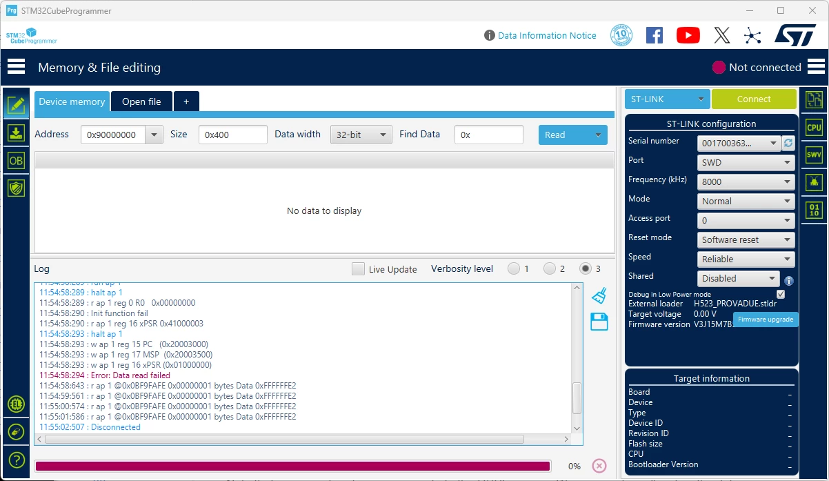

i'm trying to develop a QuadSPI custom loader for STM32H563ZI with Macronix flash MX25L25645G. I started using the custom loader example attached in youtube video of ST (https://www.youtube.com/watch?v=XqCq0xtQmbI) ,porting library from QSPI to XSPI.

January 20, 2025
Hi all,
Thank you so much, very helpful!
@Tesla DeLorean  i'm using the following pins:
  • OCTOSPI1_IO3 --> PF6
  • OCTOSPI1_IO2 --> PF7
  • OCTOSPI1_IO0 --> PF8
  • OCTOSPI1_IO1 --> PF9
  • OCTOSPI1_CLK --> PF10
  • OCTOSPI1_NCS --> PE11

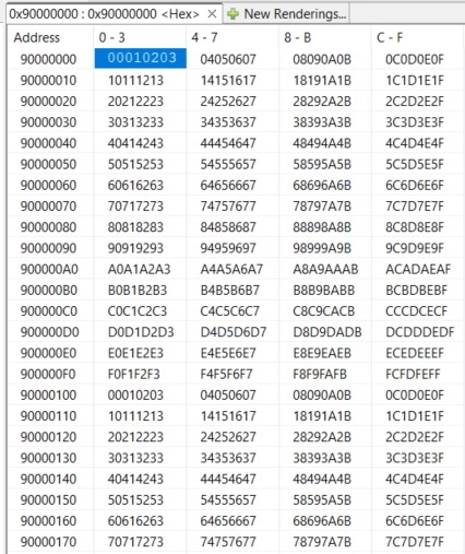

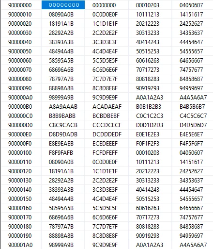

January 20, 2025
Hi @ABasi.2 ,
thanks, my configuration is similar as yours, it returns an error in the last check:
for(var = 0; var < SECTORS_COUNT; var++)
if(memcmp(buffer_test,(uint8_t*) (0x90000000 + var * MEMORY_SECTOR_SIZE),MEMORY_SECTOR_SIZE) != HAL_OK)
while(1); //breakpoint - error detected - otherwise QSPI works properly
Seems is not writing correctly data on the address 0x90000000
ABasi.2
Senior
January 20, 2025
Hi berto
i think there are some dummy clocks in your configuration that are wrong, another guy in this forum have an issue similar to yours and resolve managing the dummy clocks
check the parameter
sCommand.DummyCycles
 according to your memory datasheet
January 20, 2025
Hi @ABasi.2 ,
Thank you! I try to check this parameter, do i need to modify this just in the write funcion or in all commands functions?
January 21, 2025
thanks so much for your suggestions, i'm trying to set up the correct dummycycles parameter.

Sorry for late reply, in meantime i got my own hardware with STM32H523RCT and Macronix MX25L25645G.
I'm testing the loader and having the results attached, seems working correctly.
But when I create the .stldr file and place in STM32CubeProgrammer I can't read neither erase. Do you have any suggestion on this issue?
Thanks in advance.

Hello Berto!
it seems now your write and read functions work correctly
which is the error the programmer said?
if i have to guess:
1) did you have commented the "test function" you have used in your mail to test the read/write fuctionality?
2) is it possible to view the linker file the cube create for you and the custom linker you have created?
3) if you have created a new linker did you change the path to the new linker file?
best reguards

Sure, attached you can find both linker files.
Yes i tried both, commenting testing functions and setting the path of created linker.
Cubeprorgrammer returns the following error:
Do i need to flash a test.bin before start reading the first time?
Thanks so much

hello
i didnt see the two linker file Berto
maybe there is an error in the Dev_Inf.c file or Loader_Src.c file?
i attach here mine, make sure in Loader_Src.c Init function to use the correct address for SCB->VTOR
