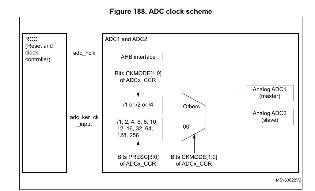

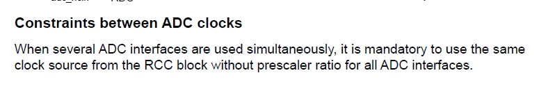

mƎALLEm
Apr 12, 2024 4:18 PM UTC
I think it's linked to this constraint on ADC clocks (from RM0481):
So you can't set different prescalers for different ADCs.
AScha.3
Apr 12, 2024 4:31 PM UTC
see from rm:  clock/divider -> serving both ADC analog blocks
