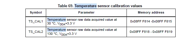

Hi All,

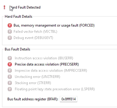

Today I received two NUCLEO-H503RB boards, but when trying to get the ADC calibration values the processor HardFaults. According to the datasheet it's the correct address:
Also when trying to access it with the debugger it fails
Also the temperature sensor calibration seems defective.
Something I'm doing wrong or are Nucleo's not calibrated or something?

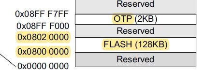

Hello Nick,
The hardfault when trying to get the ADC calibration values of the STM32H503 series could be due to the fact that these values are located in a read-only area. By default, all the AHB memory range is cacheable. For regions where caching is not practical (like OTP, RO), the MPU has to be used to disable local cacheability. This information is mentioned in the Reference Manual. If you're trying to access these locations without disabling cacheability, it could lead to a hardfault. Please ensure that you're correctly configuring the MPU to disable cacheability for these regions.

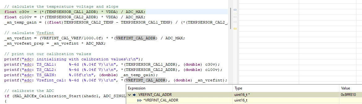

Hello @Nick van IJzendoorn ,
I did a test and get CAL1 and CAL2 as shown below and didn't face any issue:
May be it's due to some math operations in your code.
Could you please share a minimal project that reproduces the behavior?
mƎALLEm
December 8, 2023
Hello again,
Thank you @CMYL .
I did again the test but:
CAL1 = *TEMPSENSOR_CAL1_ADDR;
CAL2 = *TEMPSENSOR_CAL2_ADDR;
was called after enabling the cache  (HAL_ICACHE_Enable()) and fall in the hardfault.
So please disable the cacheability where caching is not practical (OTP, RO, data area) as described in the referance manual.

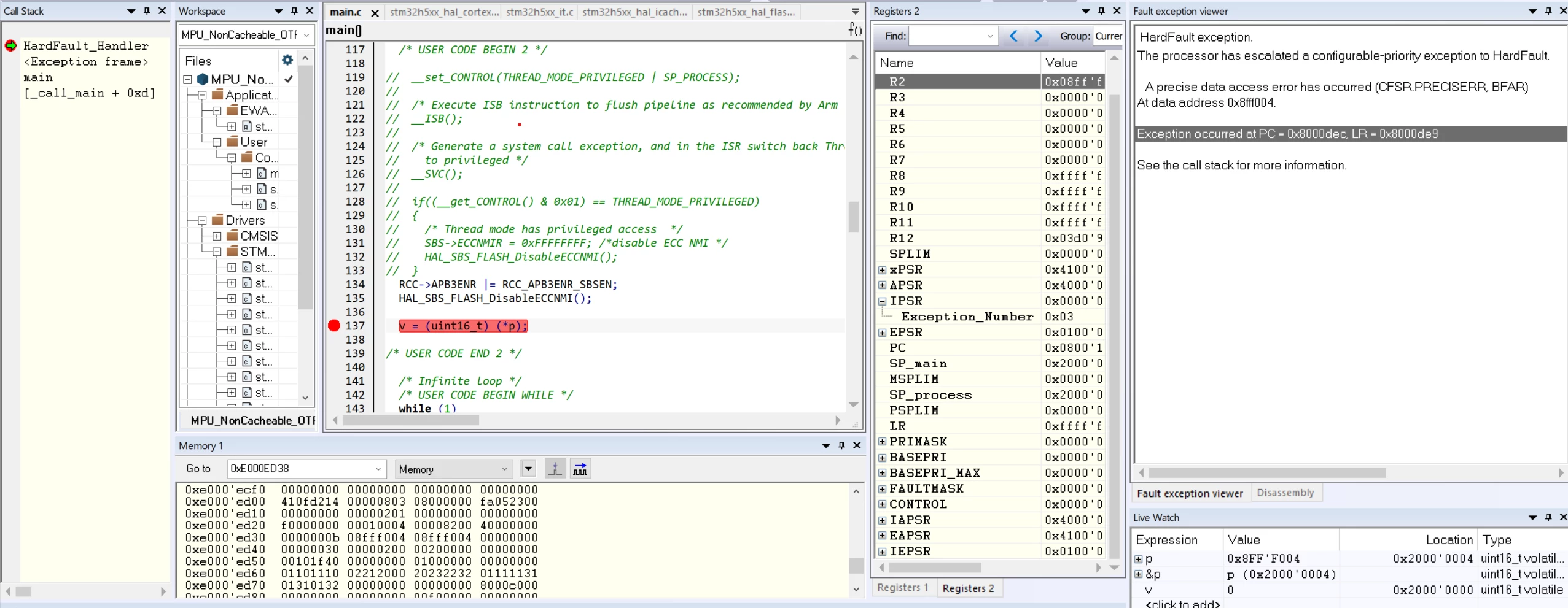

Hi @CMYL ,
I am attempting the same thing as @Dahua , on the STM32H503, with no success. I've tried using your MPU config template, but with the following addresses:
 region.BaseAddress = 0x08FFF000;
 region.LimitAddress = 0x08FFF7FF;
The program still hangs when I try to read OTP memory:
 volatile uint16_t *p = (uint16_t *) 0x08FFF000;
 uint16_t v = *p;
Same thing with a 32-bit access.
This occurs whether ICACHE is globally enabled or disabled.
Any idea what I'm doing wrong? Thank you.

Hello @Torin
By debugging your code I found that you fall into a bus fault.
According to RM0499 section 7.3.9 (OTP and RO memory access) this is expected:
If the OTP address you accessing is virgin, it is expected that the embedded flash memory detects ECC errors and NMI is raised. Because if you read addresses already programmed such as TRIM values of TSCAL1/2 or VREFINT (example 0x08FF_F814 of TSCAL1) there is no issues seen.
In my understanding the NMI is escalated to a bus-fault. I'm checking internally how is it possible to read virgin OTP values without any issues.
Best regards,
