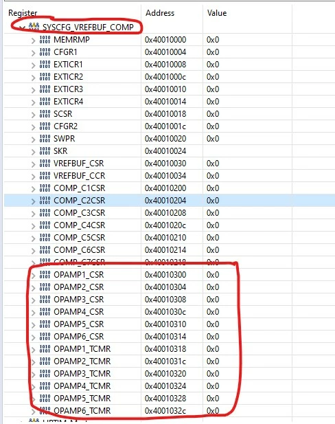

STM32G4xx.svd file OPAMP missing

OPAMPs are not missing: they are only placed in an unusual position. See attached photo:
Best regards
Andrea

Thank you very much :)
