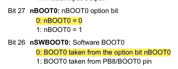

Oct 12, 2025 4:21 PM UTC
In the option bytes, set nSWBOOT0 = 0 and nBOOT0 = 0 to always boot from user flash regardless of the BOOT0 pin. Then, you can use the PB8/BOOT0 pin however you want.
