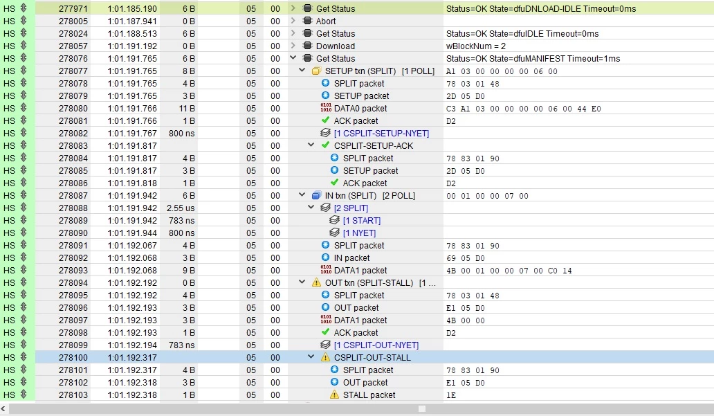

STM32G491VET6 not "leaving" dfu-util
  • September 26, 2023
  • 4 replies
  • 1967 views
I am using dfu-util (v0.11) to update the firmware on my board.
It updates correctly, but I get a LIBUSB_ERROR_PIPE error during the "leave".
Looking at it with a USB analyzer, a stall is occurring during the GET_STATUS that executes the leave request.
Has anyone else seen this?
Any suggestoins on how to troubleshoot / correct this?

Hello @MButsch
Can you please try with latest release of STM32CubeProgrammer?
Imen
MButsch
MButschAuthor
September 26, 2023
I am running this version, which I think is the latest.
15:49:15 : STM32CubeProgrammer API v2.14.0 | Windows-64Bits
