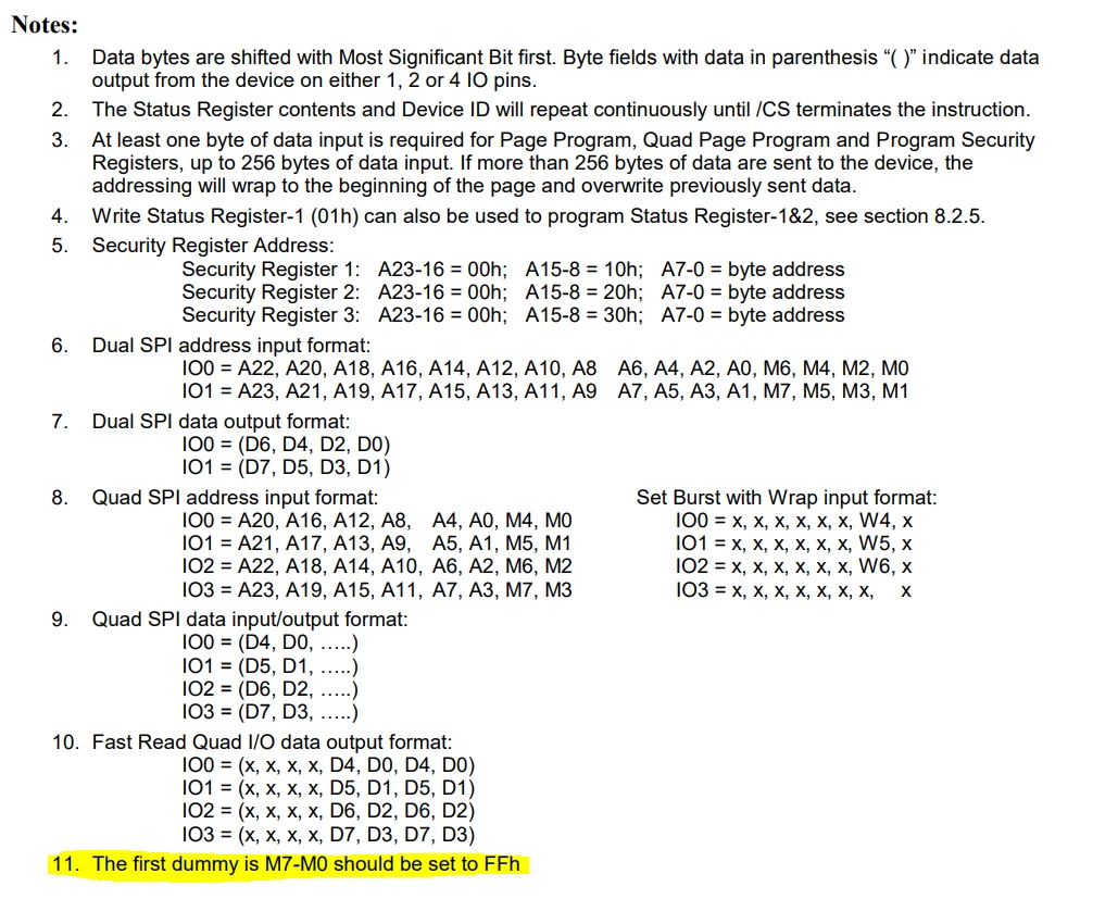

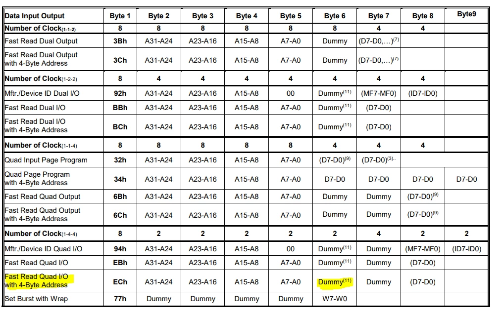

Hi @zeboss49 ,
Could you please check the dummy.
As mentioned in the memory datasheet for Fast Read Quad I/O with 4-Byte Address (ECh), the first dummy is M7-M0 should be set to FFh.
Thank you.
Kaouthar
zeboss49Author
April 26, 2024
Thank you for your reply.
The dummy byte (alternate byte) and dummy cycles are set according to the device data sheet.
