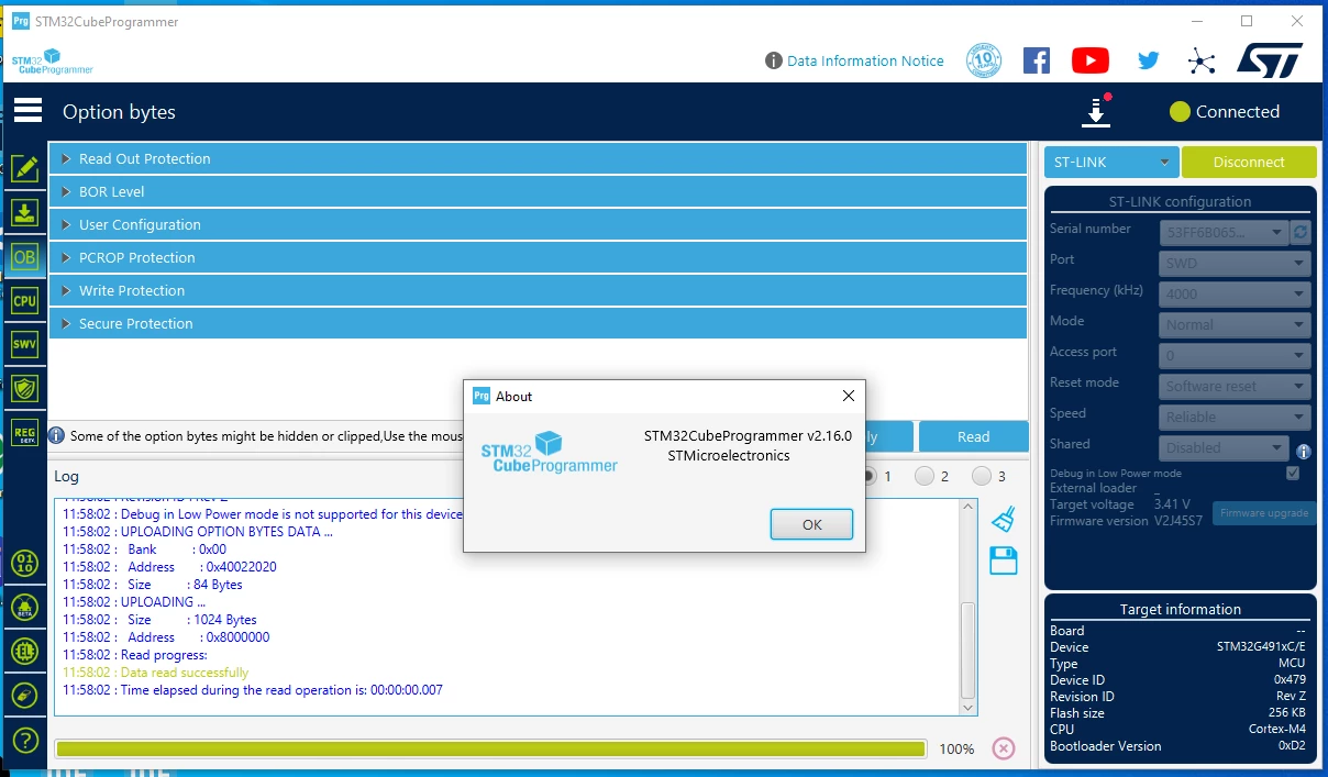

I am using an STM32G491RcT6 processor, when I connect it with ST-link to CubeProgrammer the Write Protection section of the option bytes does not appear, if I connect an STM32G491ReT6 processor it does, Document RM0440 does not seem to me to report any differences between the two microprocessors regarding this aspect.

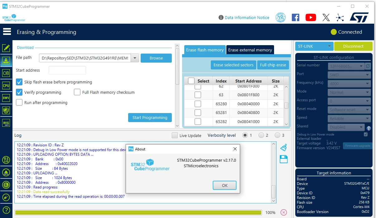

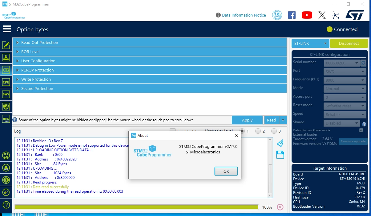

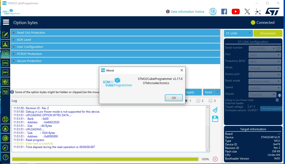

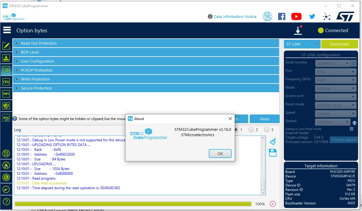

hello
sure. Here it is

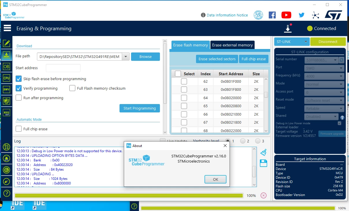

I also noticed that with the previous version of the cubeprogrammer (2.16) the option bytes are shown
Even the display of the numbering and the address of the sectors to be deleted is different
Best regards
RCT6_CubePrg_2_16RCT6_CubePrg_2_16RCT6_CubePrg_2_17RCT6_CubePrg_2_17RET6_CubePrg_2_16RET6_CubePrg_2_16RET6_CubePrg_2_17RET6_CubePrg_2_17RCT6_CubePrg_2_16_Sector_eraseRCT6_CubePrg_2_16_Sector_eraseRCT6_CubePrg_2_17_Sector_eraseRCT6_CubePrg_2_17_Sector_erase
