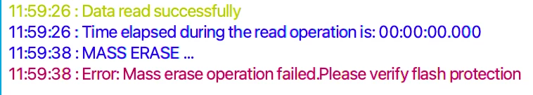

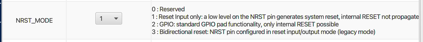

I set NRST_MODE back to 1, as you can see bellow
Then I tried to erase flash memory, but it give me a error
November 19, 2024
I figured out, how it works, so thank you for help.
