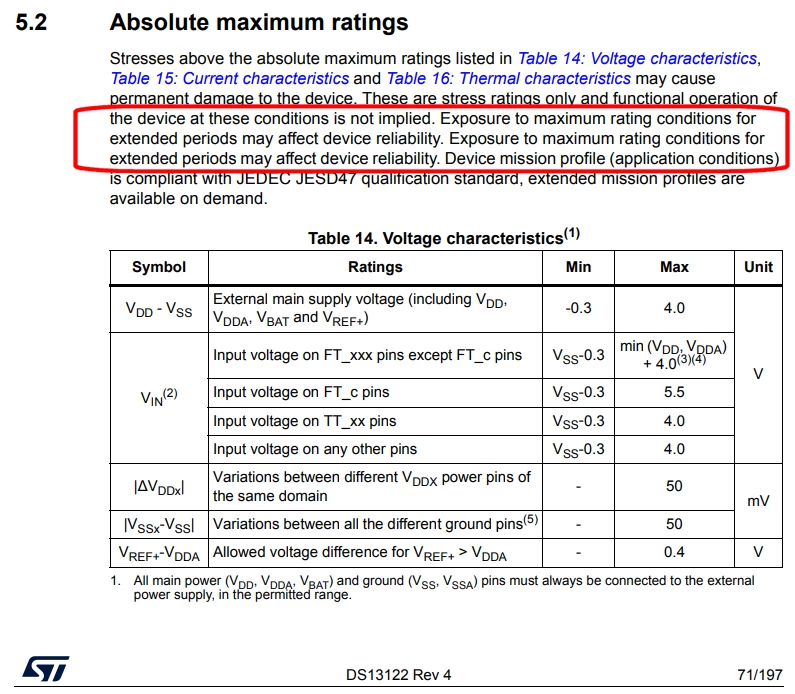

STM32G491 datasheet echo!
The sentence "Exposure to maximum rating conditions for extended periods may affect device reliability" is repeated:
2 replies
STTwo-32
September 27, 2024
Hello @Andrew Neil
Thank you so much for reporting this typo. I've report it to the concerned team for correction on the coming releases (under internal ticket number 192316).
