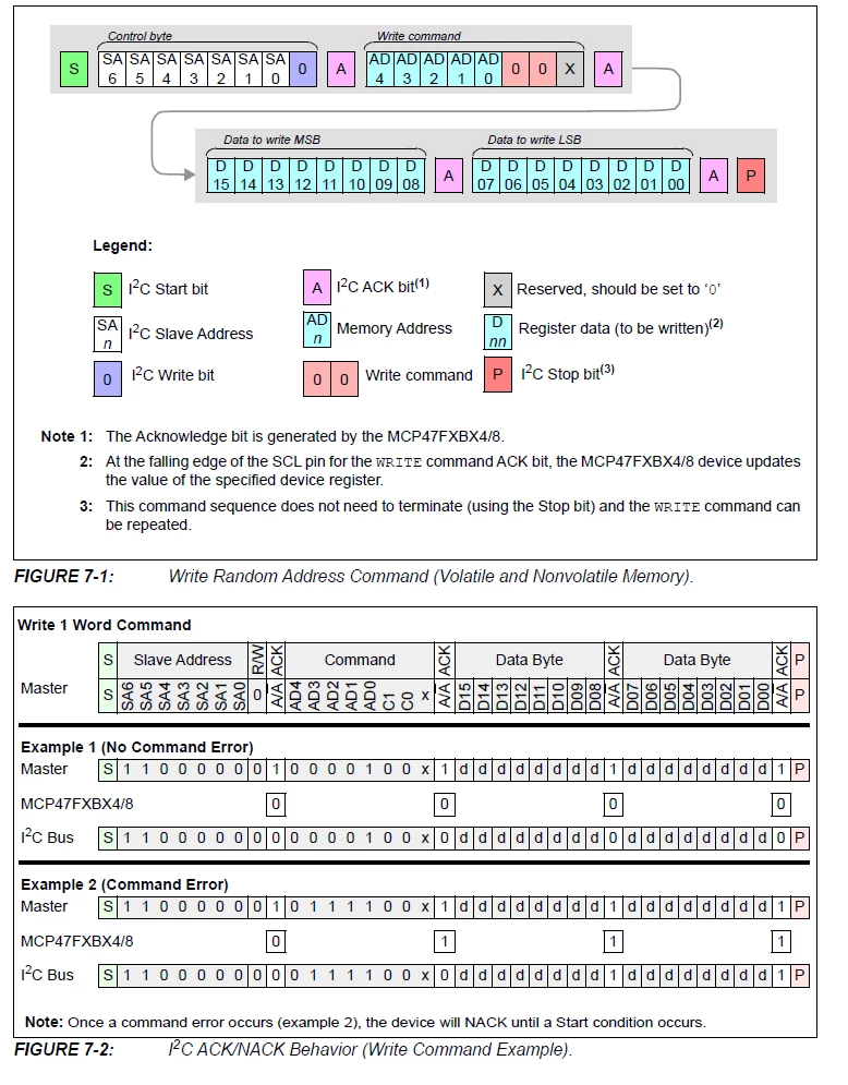

I have been trying to open communications via I2C between the STM32G484RET6 and a MCP47FXDX8 DAC using the STM32CubeIDE toolchain.

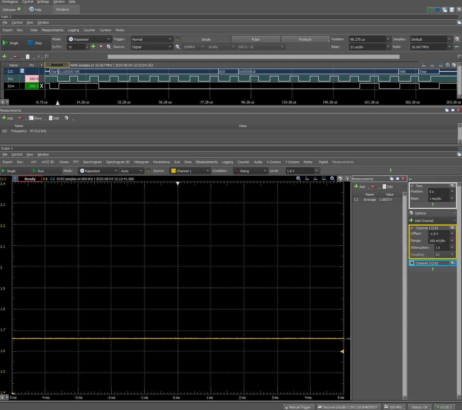

Okay I got the Logic Analyzer (LA) to give me a usable output.
However, STMCube is still reporting a HAL_ERORR.
The lower plot is the scope showing that the output of the DAC is reporting 1.6V, as opposed to the 1.3V the code is instructing it to output.
The LA does show that the 1st dataframe is correct as it is composed of the [start bit | Slave Address | Write Bit | ACK ] but then the rest seems to fall apart.
