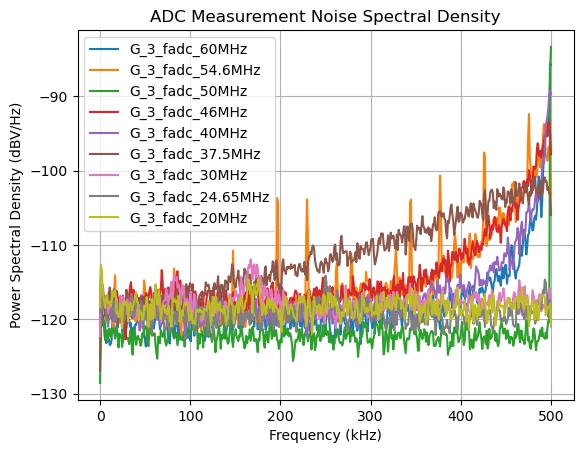

we use a STM32G483RE for analog sampling of downconverted RF signals. To maximize the signal-to-noise ratio in the digital domain we use one of the OPAMPs in inverting PGA mode with a voltage offset that is fed by a differential to single-ended amplifier with the same output common mode voltage as the PGA offset. The OPAMP is connected to the ADC internally. We did some characterization of the PGA noise density by applying no differential signal, i.e. the OPAMP in/out set to 1V DC common mode independent of the gain setting. A timer was used to trigger the ADC sampling at a fixed rate of 1 MHz.
The results of this characterization seem to resemble the datasheet noise values for the ADC with one exception, gain -3. At this gain setting we measured very large noise values. Further investigation has revealed, that it is actually not noise but seems to be related to some clock (see attached plot). The peak is always at half the sample rate, so it is possibly related to the sample rate timer. It is only measurable for ADC clock frequencies above 30 MHz and only for OPAMP gain -3.
Is this a known issue, or can anyone reproduce this behavior?
