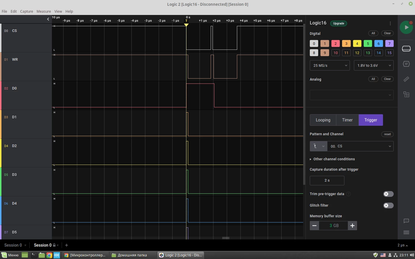

I tried to connect the display on ILI9341 to STM32G474VET6 using FMC. There were no problems with stones F1, F3, F4, F7. And with G4, an interesting plug is obtained - for each byte, a 0x00 byte is added. I read Eratu - there is nothing. I don’t even know where to dig. If anyone has met with such FMC work, tell me where to dig.

Start with schematic of connectivity
Configuration of pins and peripheral
And the code for the types of read/write operations you are performing

If 8 bit data is selected, an empty byte is added, if 16 bit data is not. Why is the high (unused) byte sent in 8-bit mode?
mlitv.1
mlitv.1Author
September 12, 2022
Carelessness.
Now
#define ADDR_CMD *(uint16_t*)0x60000000
#define ADDR_DATA *(uint16_t*)0x60040000
but you need
#define ADDR_CMD *(uint8_t*)0x60000000
#define ADDR_DATA *(uint8_t*)0x60040000
