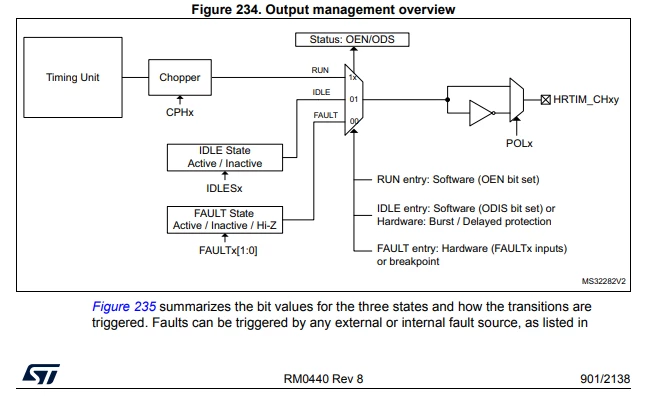

STM32G474VET3: pin names for motor controller PWM out question
HI I need to know the pin names for motor controller PWM out
PWM High and PWM LOW
i can not directly PWM out function for pins
Also need capture control pin details to measure the PWM.
As i have to assign these pins for controller

eg, for the High Resolution Timer (HRTIM):
have you also looked at Application Note AN4013, Introduction to timers for STM32 MCUs:
https://www.st.com/resource/en/application_note/an4013-introduction-to-timers-for-stm32-mcus-stmicroelectronics.pdf

All the pin names & Alternate Functions are listed in the chip's datasheet.

You'll also need to look in the Timer descriptions in the Reference Manual - that'll tell you what Alternate Functions are used ...
