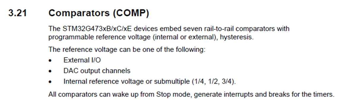

As i am using inside comparators.
For that i can see below available options for reference voltages.
My question is about DAC output can it be set internally or i have to make physical connection by DAC out put pin to comparator input

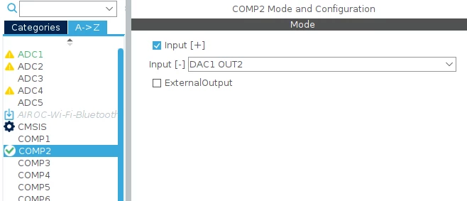

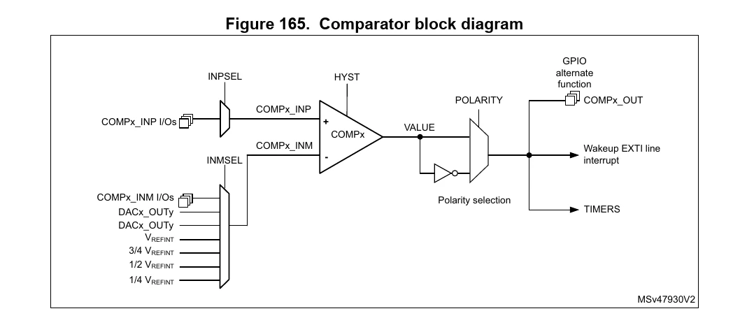

see in rm:
So internal DAC connection possible.
Just try in CubeMX , it shows , what you can select as internal connection.
example:
