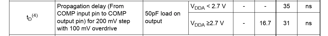

Hi i am planning to use internal comparator.
The propagation delay for comparators are 31nS which is at 25 deg C
Can you please let me know what is the all drifts and all propagation at 125 Deg C?
Thanks

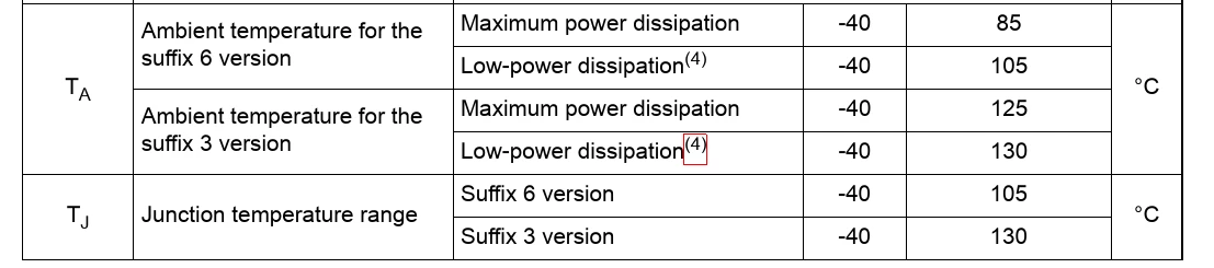

Right, from ds it should stay in/under these limits at all temp in allowed range.
(suffix 3 or 6 - look, what you have)

from ds :
So you know : prop.delay 15..31ns, offset -9 ... 3 mV , at -40...125° ambient .
If you need faster or higher precision comparator, use separate precision comparator chip.

so shall i can consider no wall these reading for max 3mV and 31nS at 3.3V is at 125 deg C ambient.
