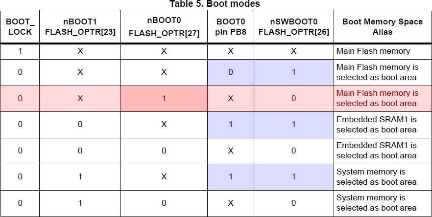

STM32G474RE write to OPTR Register because BOOT0-Pin is floating
My hardware design doesn't connect the BOOT0-Pin to a specific voltage level. That's why I need to write to the OPTR Register so that the BOOT0-Pin is not read at the boot sequence.
I check the OPTR Register:
FLASH->OPTR = ffeff8aa
 RDP = aa
 BOR_LEV = 0
 nRST_STOP = 1
 nRST_STDBY = 1
 nRST_SHDW = 1
 IWDG_SW = 1
 IWDG_STOP = 1
 IWDG_STDBY = 1
 WWDG_SW = 1
 BFB2 = 0
 DBANK = 1
 nBOOT1 = 1
 SRAM_PE = 1
 CCMSRAM_RST = 1
 nSWBOOT0 = 1
 nBOOT0 = 1
 NRST_MODE = 3
 IRHEN = 1
I need to clear the nSWBOOT0 so that the BOOT0-pin is not been evaluated anymore.

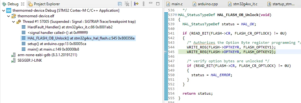

FLASH_OBProgramInitTypeDef FLASH_OBInitStruct;
HAL_FLASHEx_OBGetConfig(&FLASH_OBInitStruct);
FLASH_OBInitStruct.OptionType = OPTIONBYTE_USER;
FLASH_OBInitStruct.USERType = OB_USER_nSWBOOT0;
CLEAR_BIT(FLASH_OBInitStruct.USERConfig, FLASH_OPTR_nSWBOOT0);
printf("FLASH_OBProgramInitTypeDef\n");
printf(" OptionType = %" PRIx32 "\n", FLASH_OBInitStruct.OptionType);
printf(" RDPLevel = %" PRIx32 "\n", FLASH_OBInitStruct.RDPLevel);
printf(" USERType = %" PRIx32 "\n", FLASH_OBInitStruct.USERType);
printf(" USERConfig = %" PRIx32 "\n", FLASH_OBInitStruct.USERConfig);
printf(" PCROPConfig = %" PRIx32 "\n", FLASH_OBInitStruct.PCROPConfig);
printf("\n");
/* Unlock the option bytes block access */
HAL_FLASH_OB_Unlock();
HAL_FLASHEx_OBProgram(&FLASH_OBInitStruct);
/* Launch the option byte loading */
HAL_FLASH_OB_Launch();
/* Locks the option bytes block access */
HAL_FLASH_OB_Lock();
... that outputs the right value...
 OptionType = 4
 RDPLevel = aa
 USERType = 2000
 USERConfig = fbeff800
 PCROPConfig = 0
... but it goes to the HardFault_Handler:
0693W00000FBoVkQAL.pngMy question: why?

I found something related here: Unlock readout protection
It first unlocks the Flash itself with HAL_FLASH_Unlock()
Now it works!
