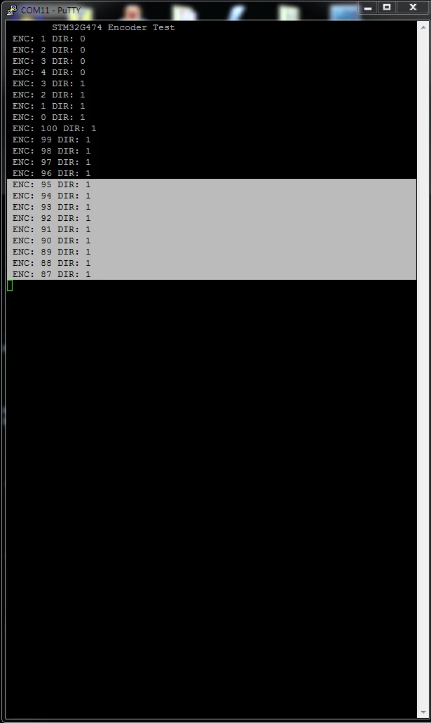

On RST, I get the following results:
       STM32G474 Encoder Test
 ENC: 1 DIR: 0
 ENC: 2 DIR: 0
 ENC: 3 DIR: 0
 ENC: 4 DIR: 0
When I turn the encoder CW, I get:
 ENC: 3 DIR: 1
 ENC: 2 DIR: 1
 ENC: 1 DIR: 1
 ENC: 0 DIR: 1
 ENC: 100 DIR: 1
 ENC: 99 DIR: 1
 ENC: 98 DIR: 1
 ENC: 97 DIR: 1
 ENC: 96 DIR: 1
When I turn the encoder CCW, I get:
 ENC: 95 DIR: 1
 ENC: 94 DIR: 1
 ENC: 93 DIR: 1
 ENC: 92 DIR: 1
 ENC: 91 DIR: 1
 ENC: 90 DIR: 1
 ENC: 89 DIR: 1
 ENC: 88 DIR: 1
 ENC: 87 DIR: 1
Attached screenshot:
Despite what I do, the direction, does not seem to change.
Any thoughts, suggestions what I am doing wrong in here ?
Thanks,
Manu
waclawek.jan
waclawek.janBest answer
Dec 28, 2020 12:55 PM UTC
This looks much like there's no input on CH2.
5 replies
waclawek.jan
Dec 28, 2020 9:30 AM UTC
I don't understand the Cube/LL gibberish, but
> LL_TIM_ENCODERMODE_DIRECTIONALCLOCK_X1_TI12
is probably Directional Clock encoder mode, which, as the manual says:
In the “directional clock�? mode on Figure 409, the clocks are provided on two lines, with a
single one at once, depending on the direction, so as to have one up-counting clock line and
one down-counting clock line.
which is not case with the usual manually turned encoder.

waclawek.jan
Manu Abraham
Senior
Dec 28, 2020 2:50 PM UTC
Hi JW,
I was getting pretty frustrated -- Connected a scope to ENC_A and _B, things looked very well indeed.
Pulled a few hairs not knowing what to do.
Checked CH1 , CH2 waveforms on PA11, 12.
Well, as you said: one channel was dead .. The connector on CH2 was not making contact.
Changed the connector, things look quite good indeed.
Thanks a bunch! I would have lost quite a lot of hair, if not for your observation. ;)
