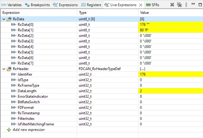

mƎALLEm
mƎALLEmBest answer
Dec 3, 2024 11:28 AM UTC
Hello @omkarprayag ,
As promised, I've created a project running on two NUCLEO-G474RE boards (same project in the attachment). I used your ioc file as a base to create the project with some little modifications. I'm using MCP2562FD as a transceiver from both sides PA11 and PA12 pins for CAN communication and it's working fine.
This is the live expression where I put the Rx data. As you can see the yellow color says that the Rx values are changing in live:
So, I'm pretty sure you have an issue with your HW.
Hope it helps.

Just to clarify something: if you are using CAN in Normal mode and you are not connecting any other node on the Bus (establishing a CAN bus), this will never work and the acknowledgement mechanism is broken.
So please confirm you are doing a test with at least two nodes that are connected on the CAN bus.
Note: CAN analyzer is supposed to be the second node connected on the bus that's why you are not seeing an issue.
