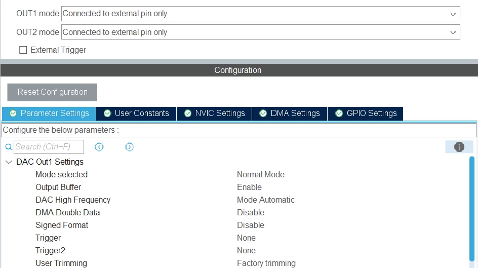

Hi guys:
          My project DAC setting as below:
           And my project that initial and code as below, it's works on EVM board (STM32G474RETX), but now works on STM32G474MCT3TR, does anyone encounter this situation?

waclawek.jan
Feb 18, 2025 9:49 AM UTC
So, where's the problem, and what are its exact symptoms?
How is reference (VREF+ pin) set up and what voltage do you measure there?
How are the DAC pins connected? Do you take into consideration their limited output current?
Read out and check/post content of DAC and relevant GPIO registers.

Hi waclawek.jan:
      The symptoms is that I can't control the DAC output 1.65v for the STM32G474MCT3TR MCU, I measure the VREF = 3.3v, VDDA also 3.3v, but still no DAC output 1.65v. I measure the DAC output by contact the STM32G474MCT3TR MCU' pin PA4 & PA5. Finally I check the DAC registers also correct too.
     Is another possible problem of the STM32G474MCT3TR MCU setting or limitation? Clock? (Now system clock is 170MHz for DAC)
Thanks a lot
Tony
waclawek.jan
Feb 18, 2025 1:54 PM UTC
Show. And show also relevant GPIO registers content.
Tony512AuthorBest answer
Feb 19, 2025 5:49 AM UTC
Hi JW:
           I change the another PCB Board and it's can DAC output normally.
           I think that is hardware issue.
           Thanks for your help!
