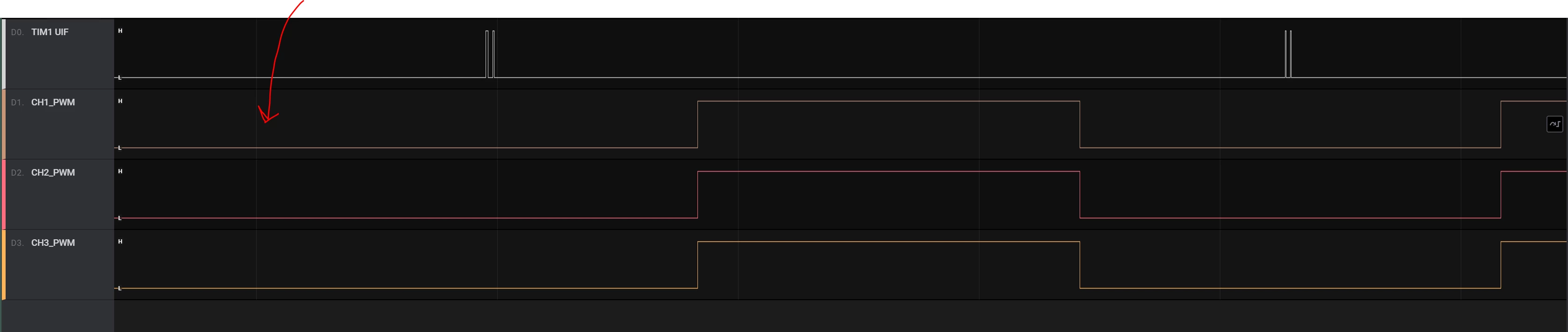

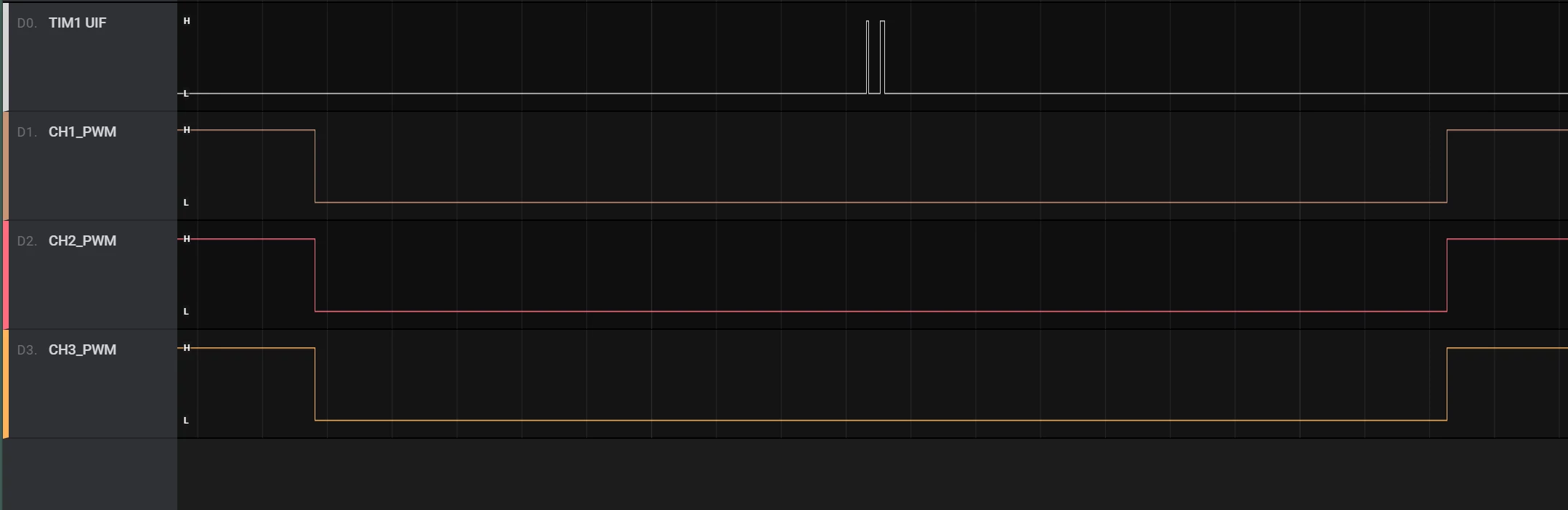

void TIM1_UP_TIM16_IRQHandler (void) {
 volatile uint8_t t;
 uint32_t sr;
 sr = TIM1->SR;
 sr &= ~TIM_SR_UIF;
 gpio_set(TIM1_PORT, TIM1_PIN);
 gpio_clr(TIM1_PORT, TIM1_PIN);
 TIM1->SR = sr;
 while (TIM1->SR & TIM_SR_UIF);
Above is the code for TIM1 Update Event Interrupt Handler. My repetition counter register TIM1_RCR value is set to 1, and I configured this to be center-aligned PWM mode.
I am triggering TIM1_PORT/TIM1_PIN GPIO just to see the interrupt happening on the logic analyzer, and I expected to see this happens every twice when overflow/underflow happens (RCR is 1)
However, as shown in the picture attached, this interrupt happens "twice in a row" IF above line 10 while loop is commented out? And when it is not commented out, it only appears once.
So the question is why did this delay happen when trying to clear the status register TIM1_SR?
Also, from this picture below, the red arrow shows that in the very beginning, when the first interrupt of Update Event happens, no Channel PWM was shown from the output pins. These channels were enabled by writing to the CCER register and BDTR register MOE bit before NVIC of this update event interrupt was even enabled.
 0693W000006H8t7QAC.pngDoes this channel enable also require delay and why?
Thanks!
Here's why.
Don't you set TIMx_EGR.UG during timer setup?
9 replies

JY.1
JY.1Author
Dec 30, 2020 5:04 PM UTC
Thanks for sharing the website and I find it very informative regarding all the gimmicks of STM32. And the example I provided was just a way to see if that indeed writing to SR was delayed and thus causing the issue. Obviously it is generally not a good practice to loop like that in the interrupt handler.
Anyways, setting up the TIMx_EGR.UG forcing TIM1 to set to zero before I start all channels did help. Thanks for the tips!
Dec 30, 2020 4:51 AM UTC
> sr = TIM1->SR;
> sr &= ~TIM_SR_UIF;
> TIM1->SR = sr;
If you just want to clear the update flag, you should do only:
TIM1->SR = ~TIM_SR_UIF;
Doing a read-modify-write on that can have other effects.
What is your intention with this statement? As written, the code will block forever if the update is triggered, since nothing will clear it as you're already in the IRQ handler. Setting RCR to 1 is fine, but if the timer is so fast your code can't keep up, that's not so good.
Would have been nice to show the timer setup. Not sure I really follow what you're showing in the plots.

waclawek.jan
Dec 30, 2020 2:19 PM UTC
> As a side note, the only line of code you have provided is NOT necessarily correct: it clears all the flags but that may be not always an intent.
No, that clears only one flag, TIM_SR_UIF.
Whatever the OP's intent, RMW to status registers with rc_w0/rc_w1 bits is universally wrong.
And, TDK is right in this:
is dangerous.
The OP obviously thought the flag is not cleared fast enough, that being the reason for the ISR to reenter.
