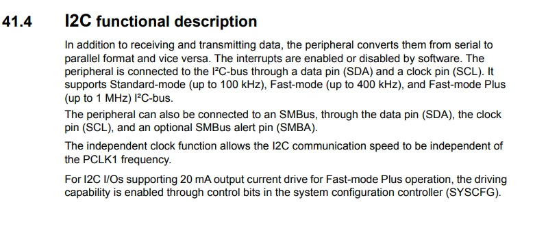

Hello @kf_SEA ,
Make sure that I2C clock speed is correctly configured and check the timing settings.
Check also the I2C pull-up resistors and the speed mode to use within the right specifications (Standard, Fast, or Fast Plus).
This FAQ describes few tips related to I2C peripheral on STM32 devices: STM32 I2C does not work - STMicroelectronics Community
