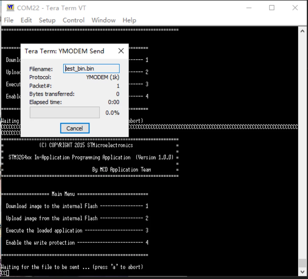

the issue I met is when I used Tera Term to transfer an APP bin file, the transfer stopped and the result is time_out as below
I am sure that the UART is OK because I can receive the menu strings and send 1 for choose download.
I will attach the project file as attachment(it seems cannot attach), please give me some advice.

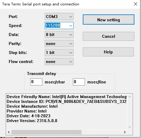

First try explain why you dont use internal system bootloader, and second why you dont scope signals and debug...
How is your TT COM config?

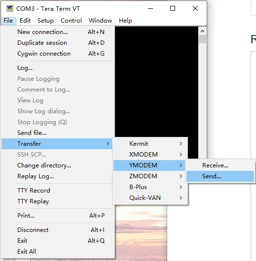

1. I want to study IAP and then expand to OTA. I am not sure use internal system bootloader can expand to OTA or not. I searched ST.com, then I get the AN4657 about IAP. can internal system bootloader expand to OTA? please give some guide.
2. I have debug to step into code, it seems HAL_UART_Receive() had a timeout always for the first byte. another guy had the same issue with me, he also posted a question, but no results from you all.
3. TT COM config as the AN4657 required, as below
send bin file as below
is something wrong?
if my TT config something wrong, how can I get the menu strings and I sent 1 for choosing download?
