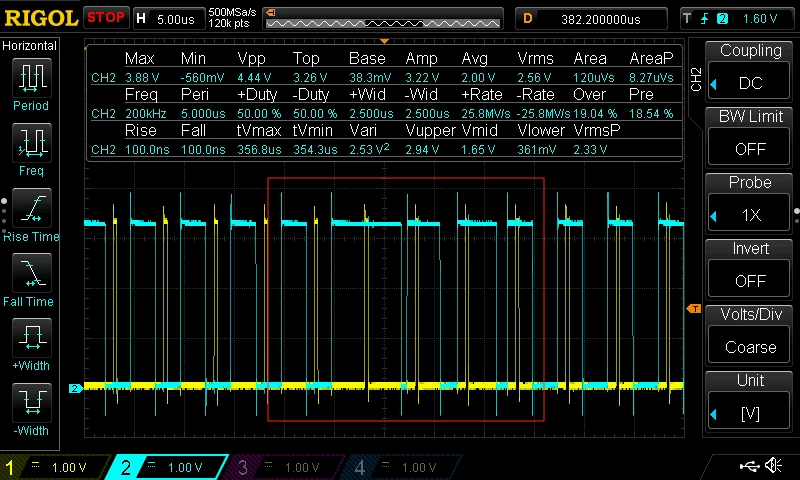

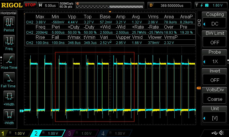

I've still haven't found a solution to the HRTIM ADC Trigger, but I've managed a workaround in calling the LL_ADC_REG_StartConversion inside TIMER B HRTIM_TIMB_IRQn_IRQHandler.
TIMER B is a dedicated UP-COUNTING timer, with CMP1 configured at 50% DutyCycle.
The workaround is functional, but not optimal, even if the TIMER B is "statically configured" the IRQ does not latch with a constant period, sometime pulses are skipped (TIMER B CMP1 is the only and highest IRQ).
Here follows the TIMER B init code:

The ISR code to manage TIMERB CMP1, toggle of a pin (simulating ADC Triggering):
void HRTIM_TIMB_IRQn_IRQHandler (void) { //HRTIM_Master_IRQn_IRQHandler( void ){
 // Code must check for a specific enabled flag
 if( LL_HRTIM_IsActiveFlag_CMP1( HRTIM1, LL_HRTIM_TIMER_B ) == 1 ){
 LL_HRTIM_ClearFlag_CMP1( HRTIM1, LL_HRTIM_TIMER_B );
 vGpioAPI_Toggle(xGpioAPI_XMI_GPIO2);
Here follows the scope acquisitions of the issue, highlighted in red:
  • in yellow is the CENTER ALIGNED PWM output of TIMER A, with a varying duty cycle
  • in blue the vGpioAPI_Toggle(xGpioAPI_XMI_GPIO2) function, called inside the TIMERB CMP1 IRQ, with fixed 50% duty.

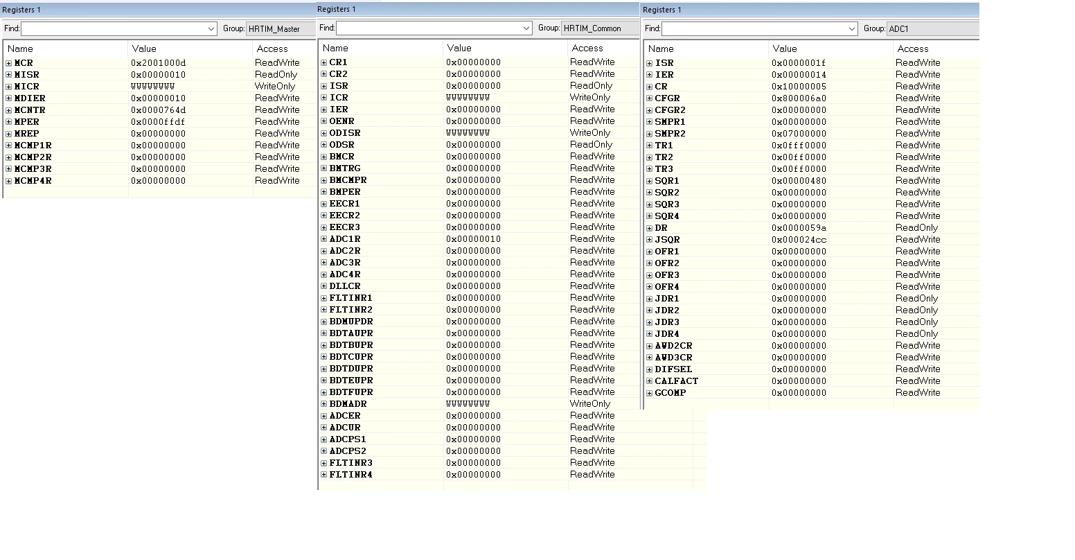

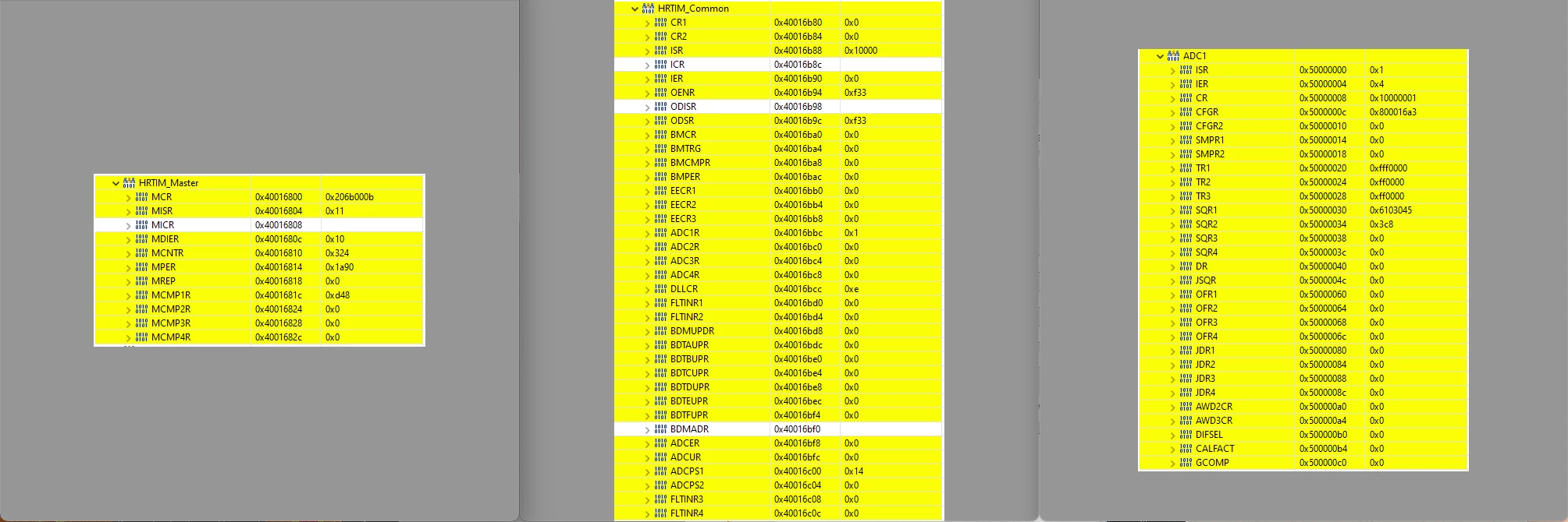

Attached is a snapshot of the HRTIM master, HRTIM common and ADC1 registers taken with a working configuration. It might help you to identify what is missing in your software. Note that as far as HRTIM is concerned, the configuration is pretty simple.

I've tried to replicate the configuration you've suggested but I still get an erroneous behaviour of the HRTIM peripheral.
That's my minima init of HRTIM, that results in the same Common & Master register configuration as indicated in your register snapshot.
HRTIM1->sMasterRegs.MCR		|= 0x2001000B;

If, instead of External, I configure the ADC to use the Software Trigger with "LL_ADC_REG_SetTriggerSource( ADC1, LL_ADC_REG_TRIG_SOFTWARE )", the acquisition pattern starts and complete without issue.
I believe my problem is that the HRTIM is not generating the TRG1 but I really cannot understand the reason. Attached you can find my registers snapshot: maybe you can spot the elephant in the room.
Thank you,
