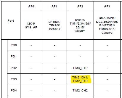

On an STM32G474QE, I intend to use PD3 for TIM2_CH1. I'm running out of pins, so this is the only practical pin for me to use.

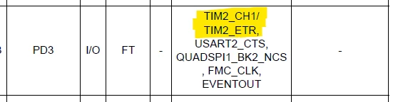

However, according to the datasheet (DS12288 Rev 6), this pin can be either TIM2_CH1 or TIM2_ETR when alternate function 2 is selected. It is mentioned in the pinout list, as well as the alternate functions table:
This confuses me. As far as I know, these two signals don't rule out each other. There shouldn't be anything preventing the developer from using ETR as a an external trigger or clock source, and at the same time use CH1 for input capture or output compare. Of course, I might be wrong about this.
I haven't found a description of this anywhere else in the datasheet. And not at all in the reference manual and the errata sheet. Nor have I been able to find a bit in the TIM2 registers that selects either CH1 or ETR for this pin.
Does anyone know what this is about? Have I missed something that should be obvious? Is it a typo that has somehow survived through numerous revisions?
Any help regarding this will be highly appreciated.
By the way, I see the exact same thing in the STM32G473 datasheet. No explanation there either.

AScha.3
May 14, 2025
Just try to set both in CubeMx on this pin, then you see...
on some pins really 2 functions can work same time, something like  ADC1 input  and ADC2 input on a pin.
Igor Cesko
Igor CeskoBest answer
May 14, 2025
There are 2 TIM functions on the same pin - there depends only from software how this can be used.
More details:
https://community.st.com/t5/stm32-mcus-products/how-to-use-tim2-etr-and-tim2-ch1-at-the-same-time/td-p/188934
  Regards
                        Igor
EThom.3
EThom.3Author
Senior II
May 14, 2025
Thank you. Reading now, and trying to comprehend...
