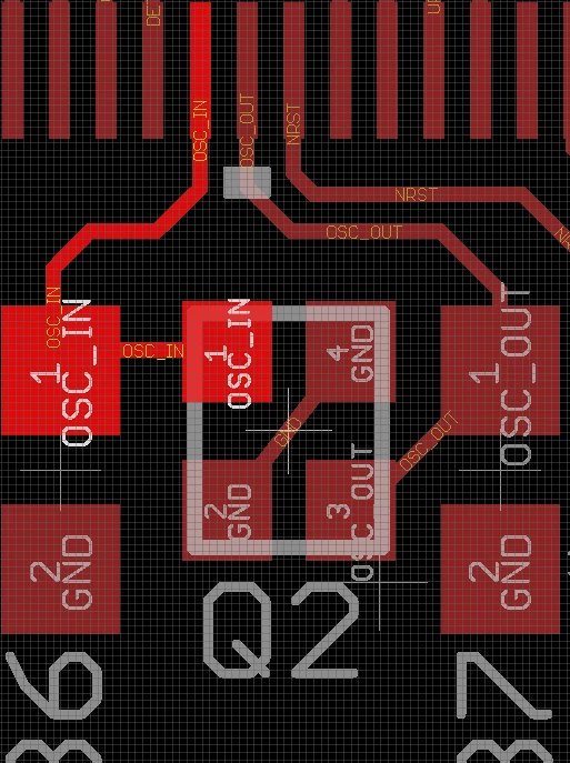

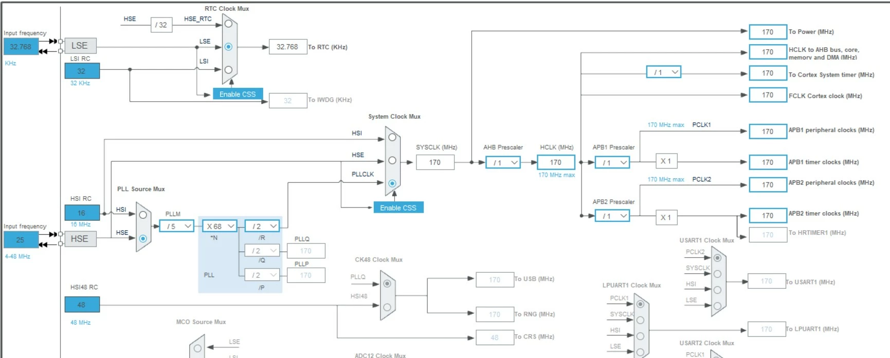

I use 25 MHz quarz (XRCGB25M000FAN00R0) together with 5.6 pF load capacitors. When I configure clock to 170MHz my program stuck here: while (READ_BIT(RCC->CR, RCC_CR_PLLRDY) == 0U).
When I configure clock to 168.75 MHz, then everything work corectly.
Can someone explain how this problem could be solved?
Thank you for answers.
Best regards

 Configuration for 170 MHz clock:
void SystemClock_Config(void)
 HAL_PWREx_ControlVoltageScaling(PWR_REGULATOR_VOLTAGE_SCALE1_BOOST);
 RCC_OscInitStruct.OscillatorType = RCC_OSCILLATORTYPE_HSE;
 RCC_OscInitStruct.HSEState = RCC_HSE_ON;
 RCC_OscInitStruct.PLL.PLLSource = RCC_PLLSOURCE_HSE;
 RCC_OscInitStruct.PLL.PLLM = RCC_PLLM_DIV5;
 RCC_OscInitStruct.PLL.PLLN = 68;
 RCC_OscInitStruct.PLL.PLLP = RCC_PLLP_DIV2;
 RCC_OscInitStruct.PLL.PLLQ = RCC_PLLQ_DIV2;
 RCC_OscInitStruct.PLL.PLLR = RCC_PLLR_DIV2;
 Error_Handler();
 RCC_ClkInitStruct.APB1CLKDivider = RCC_HCLK_DIV1;
 RCC_ClkInitStruct.APB2CLKDivider = RCC_HCLK_DIV1;
 if (HAL_RCC_ClockConfig(&RCC_ClkInitStruct, FLASH_LATENCY_4) != HAL_OK)
 Error_Handler();

koyocikAuthor
Mar 11, 2025 9:46 AM UTC
I used this equation: C1, C2 = 2*CL – 2*Cstray.
I tried use bigger capacitor value and lower but without any good result.
Quarz is connected to pins 19 and 20 like below.

koyocikAuthor
Mar 11, 2025 11:23 AM UTC
I used CubeMX for clock configuration. Do you think that code is wrong generated?
