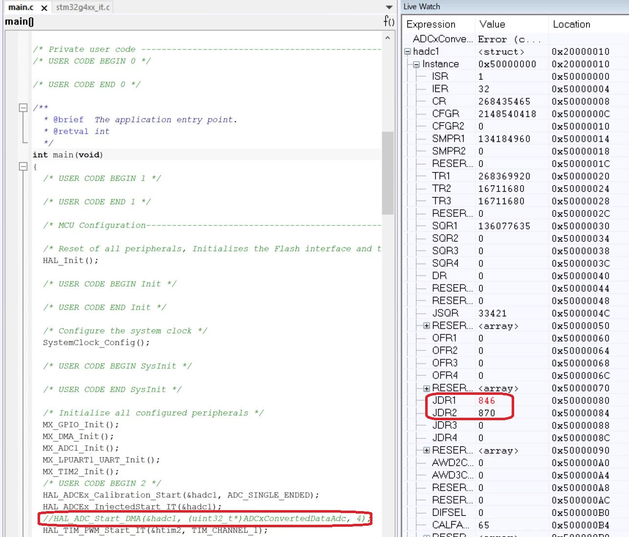

I am trying to set up my NUCLEO-G474RE board to perform ADC regular scanning mode using DMA with 4 channels and also discontinuous injection with 2 channels as shown below.
But when I run my code the injected channels always return zero or one, even if I connect their channel to 3.3V. It seems to be sampling the injected channels but for some reason instead of being connected to the actual pins their are tied low internally.

I then hit the “GENERATE CODED�? button and make the following code changes to main.c
/* USER CODE BEGIN 0 */
volatile int16_t ADCxConvertedDataAdc[4];
/* USER CODE END 0 */
/* USER CODE BEGIN 2 */
HAL_ADCEx_Calibration_Start(&hadc1, ADC_SINGLE_ENDED);
HAL_ADCEx_InjectedStart_IT(&hadc1);
HAL_ADC_Start_DMA(&hadc1, (uint32_t*)ADCxConvertedDataAdc, 4);
HAL_TIM_PWM_Start_IT(&htim2, TIM_CHANNEL_1);

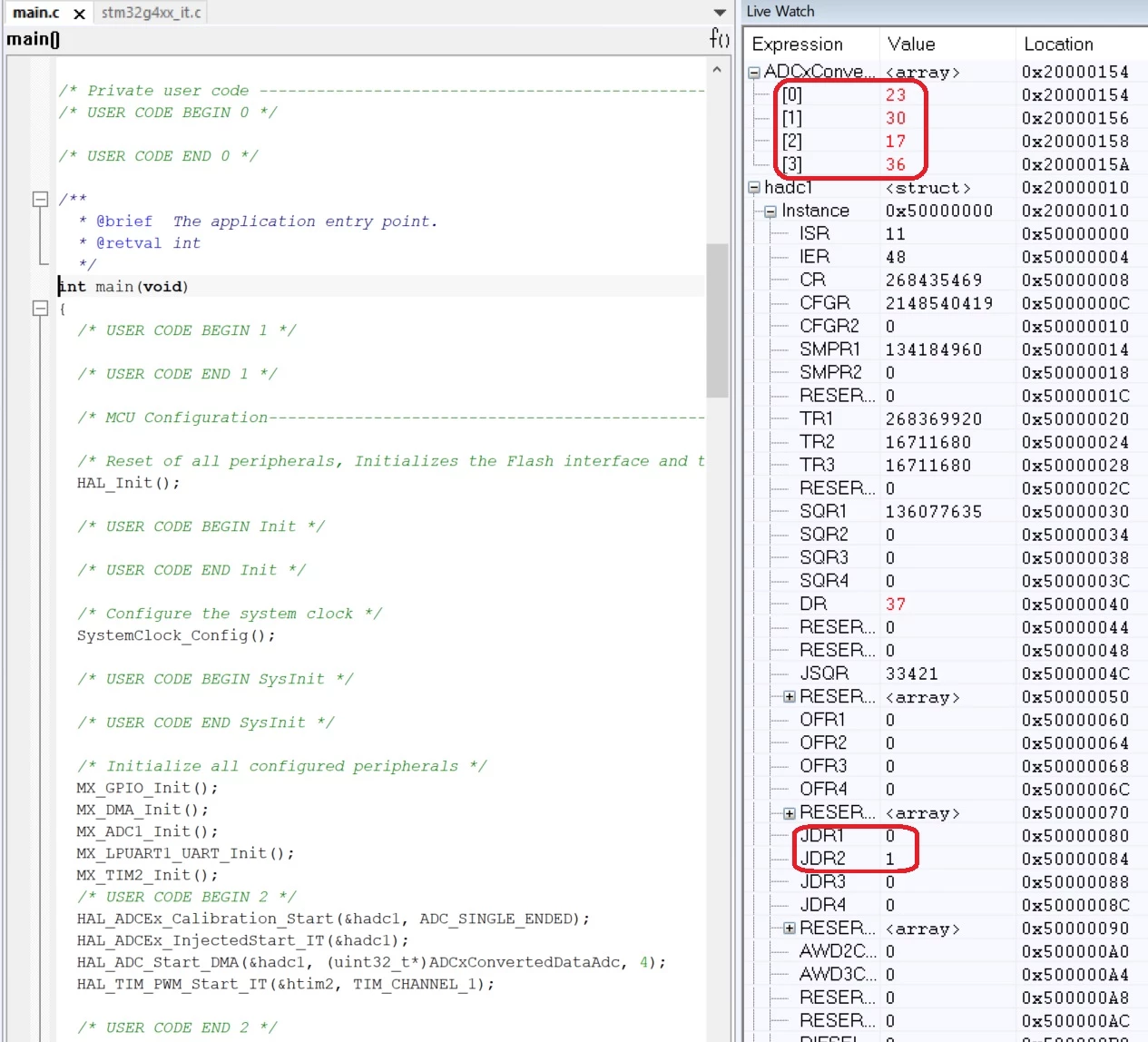

/* USER CODE END 2 *If I comment out “HAL_ADC_Start_DMA�? I can see my inject channels sampling random values every second as configured from TIM2.
But when I run with “HAL_ADC_Start_DMA�? I can see the 4 random values being continuous being sampled, but now my injected values only report zero, or sometimes ones.
I've include my ioc and source code as well as a zip file.
Hopefully I'm just doping something stupid in my code to initialise the ADC and it's not a bug in the ADC module.
