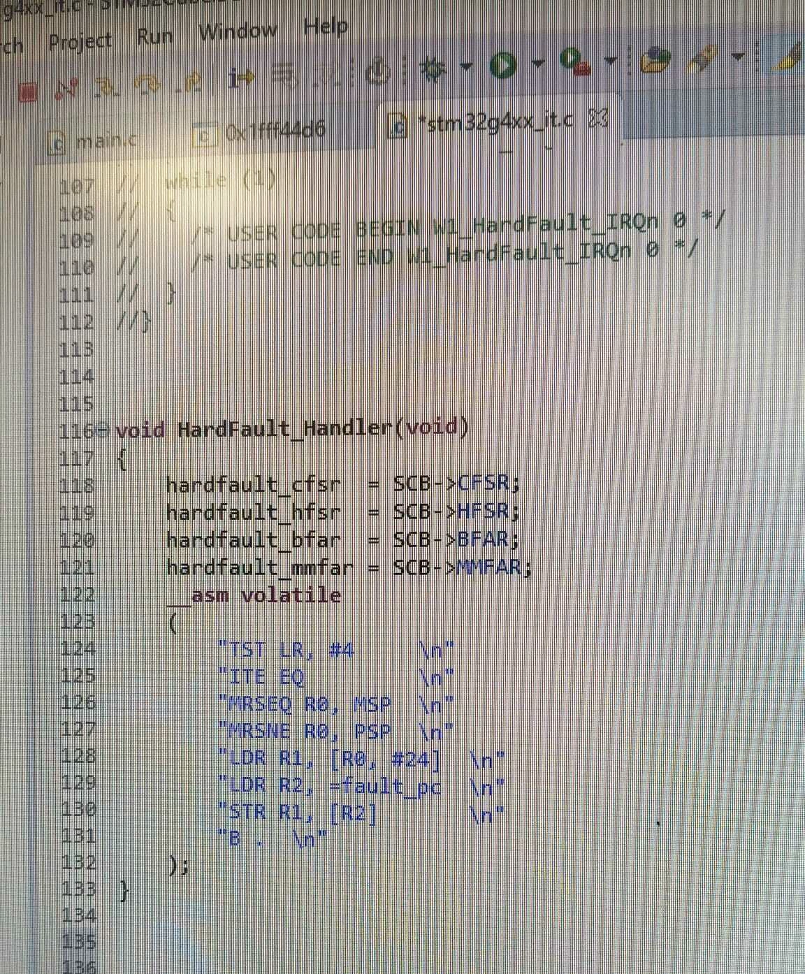

I have also modified the HardFault handler:
void HardFault_Handler(void)
HAL_GPIO_WritePin(GPIOC, GPIO_PIN_9, GPIO_PIN_SET);
while (1)
During standalone power-on, this GPIO becomes HIGH, confirming that the MCU is entering HardFault_Handler().

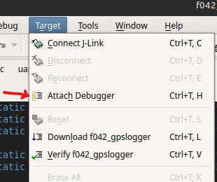

One option is to try to “attach” to the target with the debugger at runtime, once it hardfaulted.
Most toolchains / IDEs / debuggers have this option.
Here a screenshot of mine, Segger Embedded Studio
Then, stop the core, it should be in the while(1) loop of the hardfault handler.
Read out the SCB registers, to determine the cause of the hardfault.

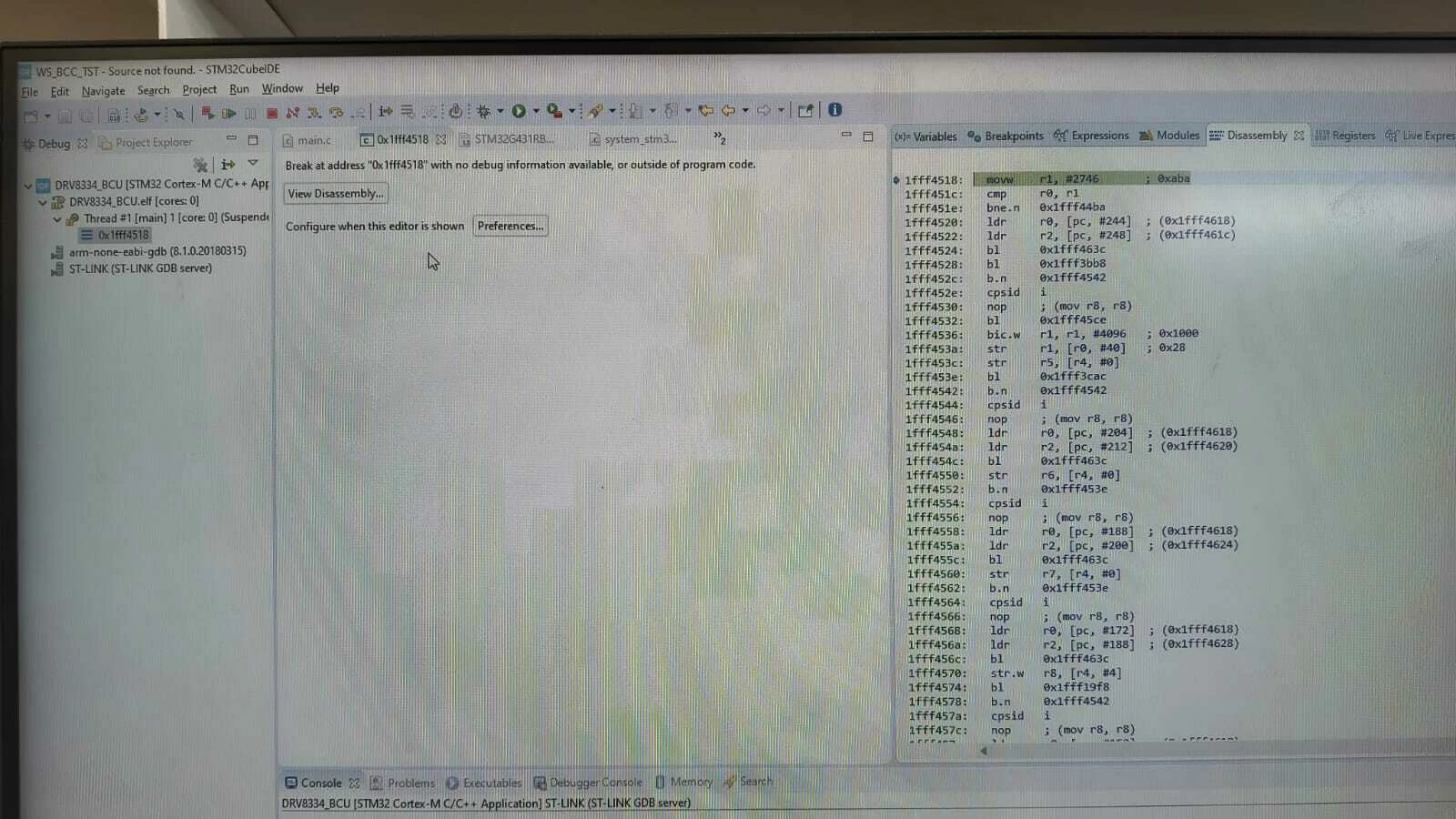

I performed the suggested reset/restart test in STM32CubeIDE.
While connected to ST-LINK, I clicked Reset and then Run/Resume. The application did not continue normally. The debugger stopped again at an address in the 0x1FFFxxxx region.
I observed:
  • 0x1FFF44D2
  • 0x1FFF4518
The CubeIDE disassembly window also shows code executing from this 0x1FFFxxxx region.
My application is located at 0x08000000, and SCB->VTOR reads 0x08000000.
According to the STM32G431 documentation, system memory is located starting at 0x1FFF0000.
Could this indicate that the MCU is entering/executing the system-memory bootloader during reset/restart? If so, what should I check regarding BOOT0, option bytes, or the reset behavior?

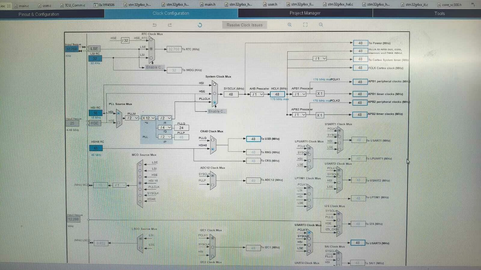

3. Clock/HSE: HSE is disabled in the CubeMX configuration and the MCU is configured to use HSI. I also removed SystemClock_Config() as a test, but the standalone HardFault problem remained. Therefore, the issue does not appear to be caused by the external HSE clock configuration.

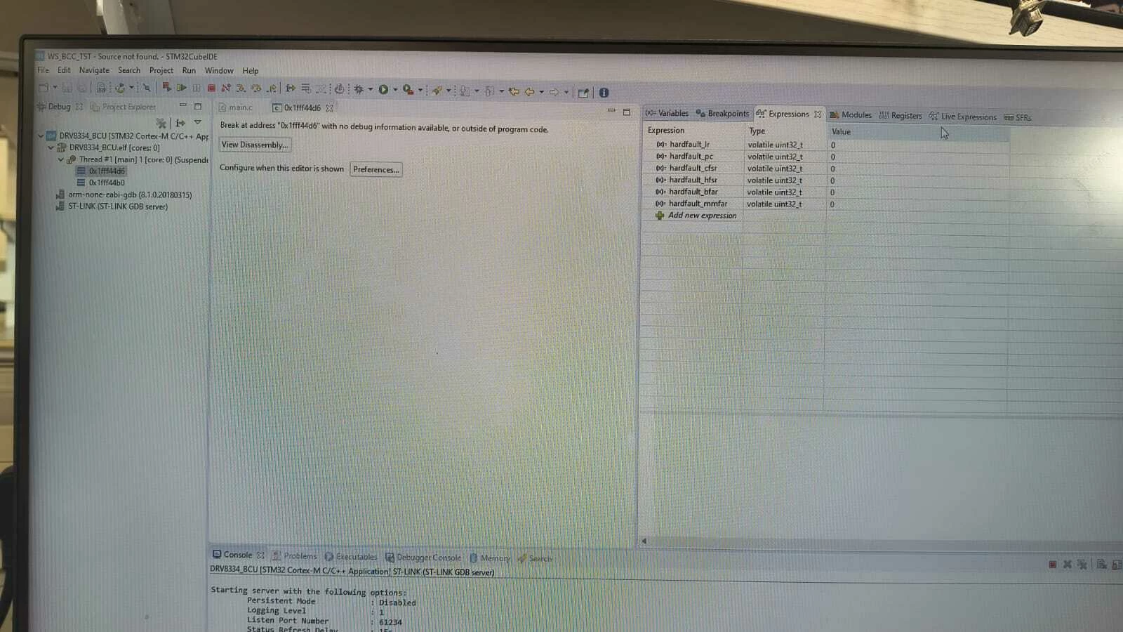

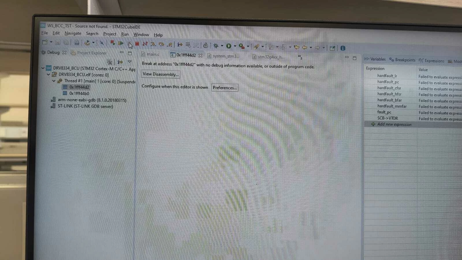

To investigate the HardFault without downloading the firmware again and potentially changing the MCU state, I then connected ST-LINK while the board was still powered and changed the STM32CubeIDE debug configuration so that Download/Program was intentionally set to Fail/disabled. I then selected Debug, but did not Run, in order to inspect the existing MCU state.
The debugger stopped at:
0x1FFF44D6
STM32CubeIDE displayed:
"Break at address '0x1fff44d6' with no debug information available, or outside of program code."
I also added the following variables to Live Expressions:
hardfault_lr
hardfault_pc
hardfault_cfsr
hardfault_hfsr
hardfault_bfar
hardfault_mmfar
All of these were displayed as 0.
However, the GPIO inside HardFault_Handler() was already HIGH from the standalone-power failure.
Therefore, I would like to understand whether attaching the debugger after the fault and stopping without downloading/running can preserve the original fault state, and whether the address 0x1FFF44D6 provides any indication of what occurred.
Could you please advise us on the correct procedure to capture the actual faulting PC/LR and Cortex-M fault status registers at the moment of this standalone power-on HardFault?
Ozone
Principal
Sep 8, 2026 8:32 AM UTC
This what the option “Attach debugger” means.
The respective values will remain in the SCB registers until the next power cycle or core reset.
I’m not a CubeIDE user.
But I expect such basic debugging options to be well documented, both as written tutorials and as videos.

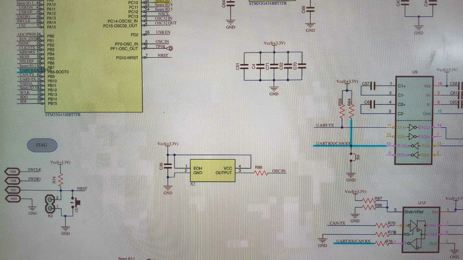

Sep 8, 2026 12:20 PM UTC
Issue is Finally Resolved. Thank You.
Since the code was breaking at an address related to the boot process, we suspected a BOOT/boot-mode related hardware issue. Based on the suggestion to check the BOOT pins and debug with a minimal project, we verified the following:
1.We created a minimal firmware with only basic GPIO functionality to rule out any application-level issue.

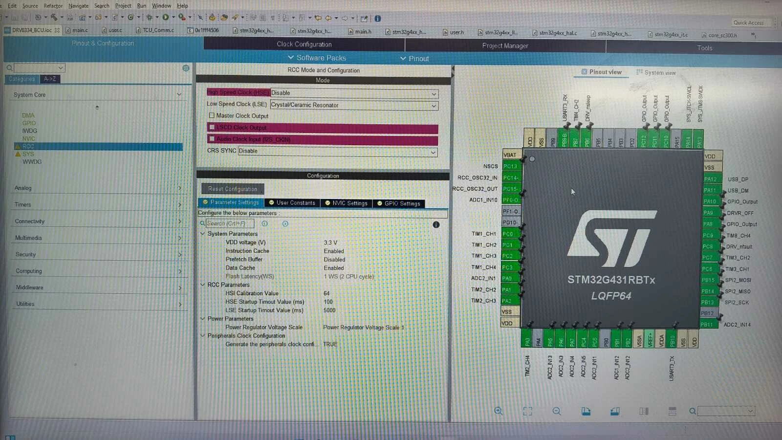

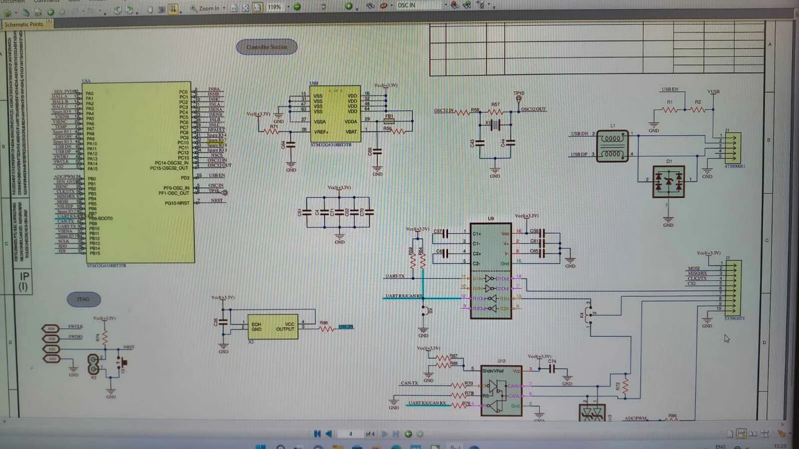

2.We checked PB8, which is the BOOT0 pin on the STM32G431RBT3 and is also being used as UART RX / CAN RX in our    design.
3.With the RS232 and CAN transceivers connected, PB8 was observed HIGH during startup.
4.We removed the RS232 and CAN transceivers from the board as an isolation test. After removing them, PB8 became LOW and the MCU booted the application correctly in standalone mode, without ST-LINK.
5.This confirmed that the external transceiver circuitry connected to PB8 was affecting the BOOT0 level during startup.
6.We then checked the STM32 option bytes. Initially, nSWBOOT0 = 1, meaning the physical PB8 pin was being used for BOOT0 selection.
7.Using STM32CubeProgrammer, we changed:
  nSWBOOT0 = 0
  nBOOT0 = 1
  nBOOT1 = 1
8.With this configuration, BOOT selection no longer depends on the physical PB8 level, and the MCU boots from Main Flash.
9.After restoring the RS232 and CAN transceivers, we tested the board both with and without ST-LINK, and the firmware now runs correctly in standalone operation.
So we identified the issue as a BOOT0/PB8 conflict with the external transceiver circuitry, and changing the BOOT option-byte configuration resolved the standalone boot problem.
