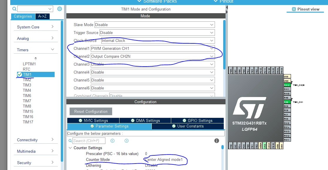

I have configured the TIM1 with PWM CH1 and CH1N, with 62.KHz frequency .
I am getting the 180 degree phase shift for 50 % duty cycle .If i vary duty cycle to 30 % then CH1 =30% and CH1N will be 70 % and it is inverted .I need same duty cycle with 180 degree Phase on two PWM ports .
please can some one answer this how to achieve this ??

On the 'G4 you could use Asymmetric/Combined mode to arbitrarily phase-shift one or two waveforms, but for this particular application it's probably simpler to use plain PWM and center-aligned (up-down counting) mode.

On second thought... you probably could use the tim in center-aligned mode (up-down), use CH1 to generate one waveform as normal PWM, and use CH2 in Combined OR mode while inverting it by setting TIMx_CCER.CC2P.
Read the Combined mode subchapter in TIM chapter in RM, and the description of it within description of TIMx_CCMR.OCxM field. Then experiment, best on a Nucleo or similar, while observing the outputs using LA or oscilloscope.

Thanks every one . I am able to generate the Two PWMs with Phase shift of 180 degree with equal duty cycles on CH1 and CH2
1.Selected TIM1 Channel1 -PWM Generation CH1 and Channel2-PWM Generation Channel CH2
2.Selected The Clock 170 MHz and Counter Mode ->Center Aligned Mode1 and Counter period =2720
3.In the PWM generation Channel 1-> pulse =Duty cycle value
4.In the PWM generation Channel 2-> pulse =Counter period - Duty cycle value and CH Polarity LOW
I made above settings and getting the PWM pulses and if any corrections or any other methods please let me know
