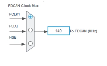

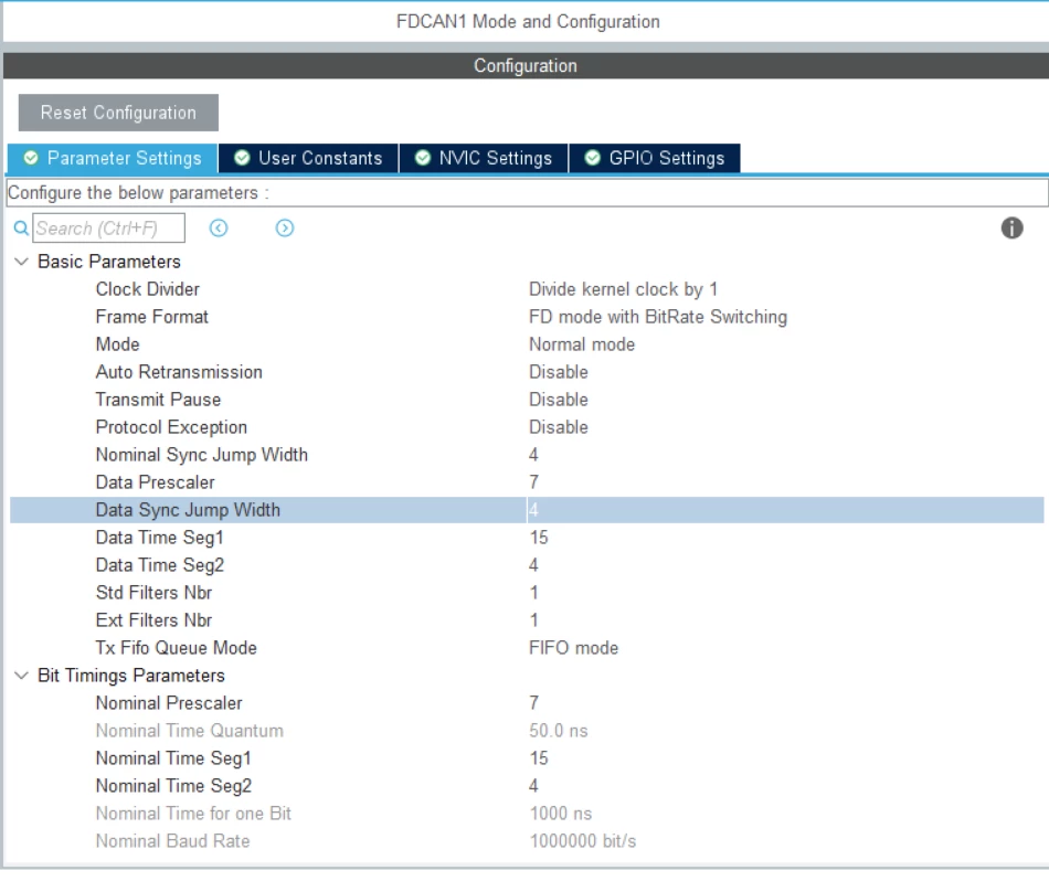

Hi community:
     I'm using CANFD on stm32g431kbu6 board, but I find some issue that CANFD cant work normally with BRS ON,my config of CANFD show in the comments。Does anyone know about this?
Thanks

You need to increase TSEG1 and TSEG2 as much as possible an decrease the prescaler either for Nominal or data phases.
TSEG1 ~= 80% (TSEG1+TSEG2) for sampling point at 80%

  1. What do you mean by "cant work normally"? no transmit? no receive? sometimes work sometimes not? please be concise.
  2. Did you test your solution in Loopback mode?
  3. Please provide details about your HW? which board? ST board? custom board? how about the transceiver? which transceiver part number?
  4. Please provide details about your CAN bus config? what is connected to?
  5. What about the clock source you're using? HSE/HSI?
  6. What about the filter config?
Need also to share your project, schematics if possible. Hard to tell about your issue based on the few lines you posted.

OK, and I find the reason, there is another CAN node with inconsistent data area sampling points (80%)in my CAN bus,my setting is 75%,so when it work together, CAN bus hang up
mƎALLEm
May 6, 2024
Thank you for the feedback. But I'm not sure the issue is related to the sampling point. 80% or 75% as sampling points position don't make a difference, it could be something else .. May be it's a resolution of the bit time issue based on time quanta of that another CAN node.
