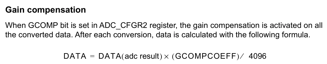

Gain Compensation is post conversion and is not analog? I guess the purpose is to maintain the dynamic range of the processing that comes after the conversion? Sounds like I need to use the internal opamp if I want true gain before conversion?
Per the reference manual:
It can be useful in oversampling.
