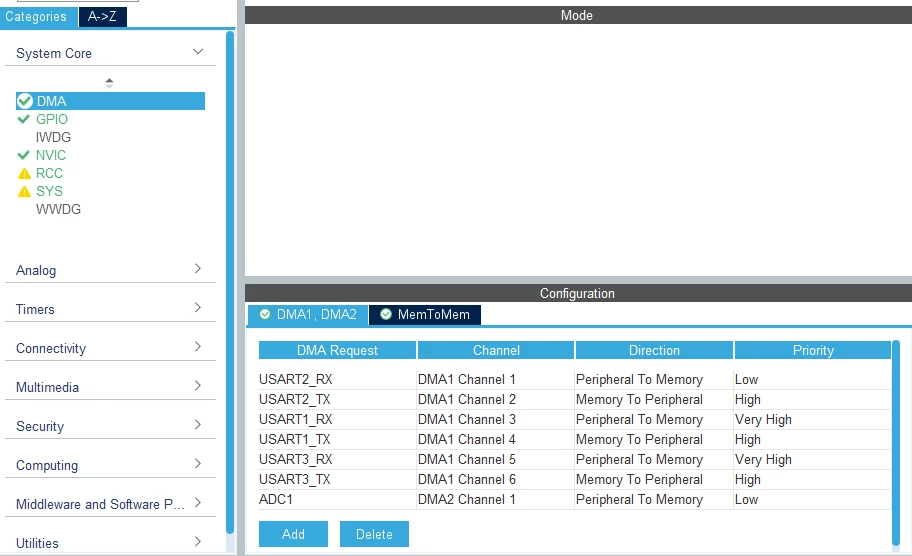

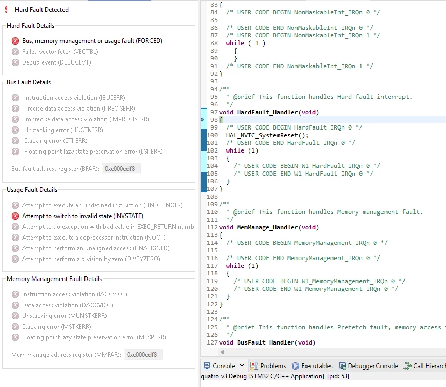

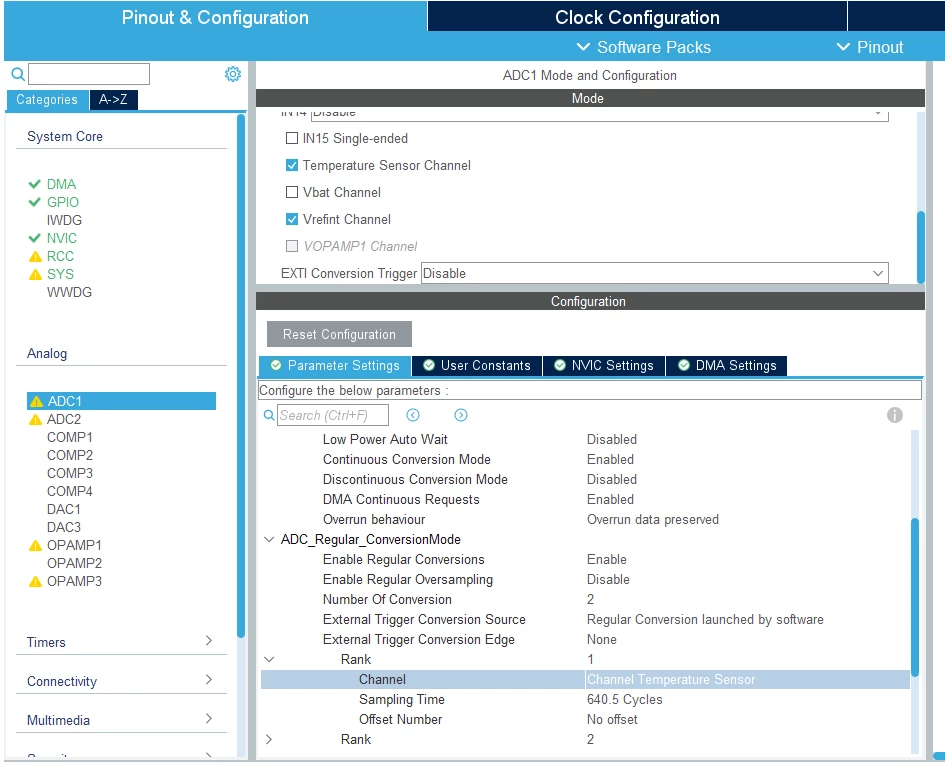

I'm using ADC with DMA in a large project, and faced some very strange problem:
If I'm using DMA2 Channel 6 - ADC works correctly
If I'm using DMA2 Channel 1 - the SW end up in Hard Fault
Screenshot 2025-10-07 125752.pngScreenshot 2025-10-07 125821.pngScreenshot 2025-10-07 124405.png
The configuration is default.
This is how I start the conversation
 HAL_ADCEx_Calibration_Start(&hadc1, ADC_SINGLE_ENDED);
 // Start the ADC in DMA mode
 HAL_ADC_Start_DMA(&hadc1, (uint32_t*) g_ADC_values, ADC_BUFFER_LENGTH);

Oct 7, 2025 1:55 PM UTC
What is the stack trace when the hard fault happens? What code is causing it to hard fault?
AChas.1Author
Oct 7, 2025 3:55 PM UTC
The random code, it depends when ADC triggers the DMA
Oct 7, 2025 5:29 PM UTC
I can't make sense of this answer.
Using DMA doesn't cause a hard fault in itself. It's possible the DMA is misconfigured, or trying to write somewhere it cannot. Look for the reason it's hard faulting and go from there.

AChas.1Author
Jan 23, 2026 8:04 AM UTC
Long story short, I can't avoid this problem but I'm almost shure it was coz of RAM tension I've got in my firmware. I lose my patience and just switch to STM32G491 - now it works like a charm :)
