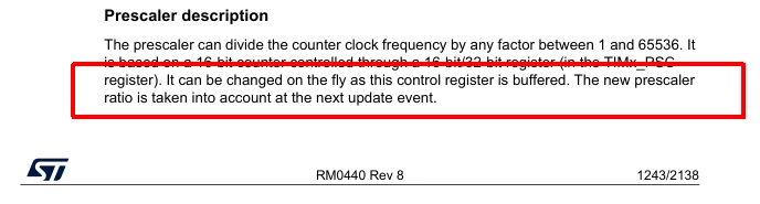

waclawek.janBest answer
Jul 20, 2026 11:07 AM UTC
TIMx_PSC is unconditionally preloaded. This behaviour is documented.

Jul 20, 2026 11:28 AM UTC
Thanks ​@waclawek.jan !
Just found the same by setting it up via CubeMx, and there I found the line:
TIM2->EGR     = TIM_EGR_UG;
Then I checked the RM again.
I never came across this before, is this a feature for “advanced” timers only?
And interesting that this is required even before the timer was ever enabled.
waclawek.jan
Jul 20, 2026 12:18 PM UTC
No, this is the same in all timers.
In 16-bit timers many users simply don’t notice that the first period was shorter. Also, “library” (SPL/Cube/LL/HAL) users won’t notice as the “libraries” tend to add setting TIMx_EGR.UG to timer initialization code.
