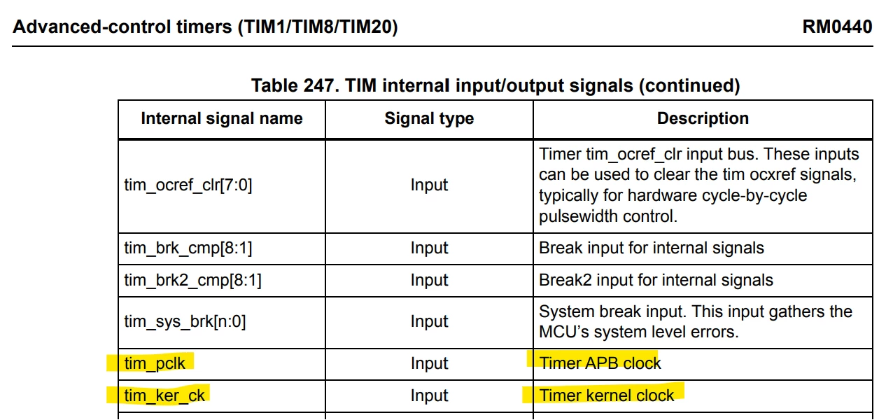

I'm looking into calculating the timings for the brk filters for the TIM1 periphery. Mentioned there is the "tim_ker_ck" and the "tim_pclk" respectively.
I cannot seem to find any information on where these come from.
The clock tree in the RM says that TIM1 is connected to the APB2 using PCLK2, however there's nothing on how PCLK2 translates to tim_ker_ck or tim_pclk.

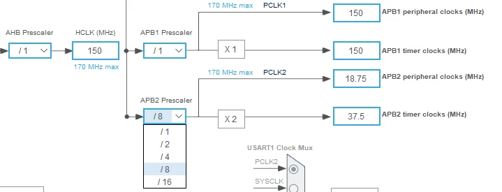

tim_pclk tim_ker_ck is either 1x the APB clock if the APB prescaler is /1, else it's 2x the APB clock.

Hello @DMeie.2,
tim_pclk is the clock used for interfacing the Timer registers (it is always PCLK2) and tim_ker_ck is the one used for internal timer counters (here PCLK2 x1 or x2). I agree documentation needs to clarify this difference in the RM0440.
  • I will submit an update to clearly differentiate between both clock inputs.

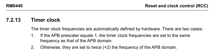

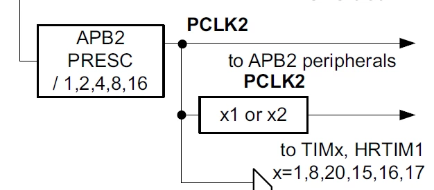

Below we are talking about the tim_ker_ck, as mentioned by @TDK, it is either PCLK2 x1 or PCLK2 x2:
  • the kernel timer clock frequencies are automatically defined by hardware. If the APB prescaler equals 1, the kernel timer clock frequencies are set to the same frequency of the APB domain, otherwise, they are set to twice (×2) the frequency of the APB domain ( see RM0440, section 7.2.13 Timer clock).
  • RM0440, Figure 17. Clock tree, shows the tim_ker_ck

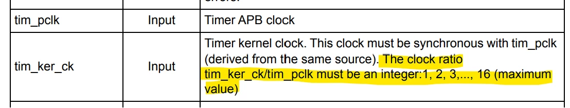

@CMYL Thanks for clearing that up. I'm wrong above then, and I'll edit it.
If it's the case that tim_ker_ck is always 1x or 2x of tim_pclk, why does the RM say the ratio must be between 1 and 16? It's always either 1 or 2, right?

tim_pclk = PCLKx, the clock ratio can be  1,2,4,8 and 16 of the AHB clock source HCLK.
tim_ker_clock is derived from the PCLKx=tim_pclk source, it is always 1x or 2x of tim_pclk.

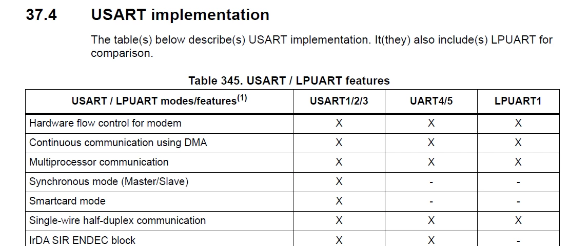

This probably is a remnant from the internal design document and a requirement for the "integration" of timers into the clock/bus fabric when designing the chips (in effect it says, that you have to derive PCLK (i.e. the entire APB bus clock) by dividing tim_ker_ck (of course there's no APB multiplier, that's just a description which is supposedly simpler to grasp (not to me btw.))). There are STM32 models where the ratio is not only 1:1 or 1:2.
As it's only in one of the 3 chapter, it at the same time also shows how bad idea it is to split the timer section into three or four, rather than to try to keep it consistent by having a single chapter and a simple table of features for the variants (and maybe a set of footnotes in the registers' description to note which bit is present/absent in which variant), as is usual in other modules (e.g. UART/USART - although that in turn is itself an extremely bad choice of naming made even worse by propagating it into the "libraries" and, what's worse, into the CMSIS-mandated device headers).
February 24, 2024
Hello @waclawek.jan
In response to your question about splitting Timers documentation into 3/4 chapters ...
Actually, I will share your suggestion to centralize into one chapter  "basic, advanced, legacy, high resolution timers" ... But in my opinion it difficult to compile all in one chapter as for UART/USART ... one reason is that there are 4 different designs/peripherals, Basic, Advanced, GP and high-res. The 3 first one can be easily merged into one chapter, but not with high-res timers in terms of the registers sets and naming. Other reason is the generic integration parameters which are different, signals for example are widely different as you can see it in the block diagrams. Besides SoC integration description such as (clock, power domains ....) or mapping (addresses/busses) are not easy at all. One more reason, one chapter will be very long .... if not compiled correctly will be error prone !!!
Add to all of that, our customers are familiar with this RM presentation ... I'm afraid what could be their reaction if merged together, but with some confusing/erroneous description .... the business is in question here :beaming_face_with_smiling_eyes:
To be constructive, what can be done easily is to add one table in each chapter that summarizes the implementation features of all timers as one for USART/UART/LPUART.
However, I didn't catch you point  (e.g. UART/USART - although that in turn is itself an extremely bad choice of naming made even worse by propagating it into the "libraries" and, what's worse, into the CMSIS-mandated device headers).
