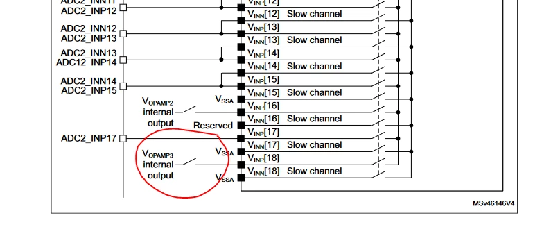

Now I had a closer look in the registers. For my device the RM0440 is the right one. My ADC does not have an ADC_CHSELR Register.
  • According to Figure 85, OPAMP3 is connected to Channel 18. The Other Inputs I use are Channel 3, 4, and 8.
  • All the inputs are selected correctly as single-ended inputs. (DIFSEL=0)
  • Channel Selection seems correct. This is given by SQR1. Bits SQ1 are 0x3 (Channel 3), Bits SQ2 are 0x4 (Channel 4), Bits SQ2 are 0x8 (Channel 8), and Bits SQ4 are 0x12 (Channel 18). Bits L are set to 0x03 (Corresponds to 4 conversions).
  • All other Sequence Regsiters are 0x0
  • Channel-wise programmable sampling time seems correct. SMP3, SMP4, SMP8, and SMP18 are set to 0x7 in SMPR1 and SMPR2.
  • All other registers also seem ok to me,
I wonder a little bit what the second switch in figure 85 is about. As far as I understand, the channel select bits only control the switches on the right side in the following picture:
I wasn't able to find further information on this. According to table 201, the adc input is connected internally to the OPAMP3_VOUT when OPAINTOEN bit is set. Do you think that this might be the second switch? However, the bit is set in OPAMP3_CSR. So everything seems fine here.
I also read Chapter 11 about the periphals interconnect matrix. But unfortunately I did not find anything here (Some connections are disabled in low power modes, which I do not use).

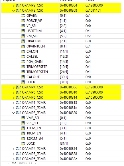

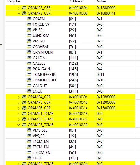

The registers without the calibration function look like (factory settings):
The registers with the calibration function look like:
During Calibration, the OPV is connected to the ADC. If the HAL-API does not distingush between the two cases, I used the wrong way of calibration. I do not use the output pin.
waclawek.jan
September 16, 2024
The difference for these two cases is quite aptly described in the last section of Calibration subchapter of ADC chapter of RM0440.
Cube/HAL does not appear to cater for this case at all, so if you are not comfortable with the factory values, you have to write your version of calibration.
PS. Nice find!
