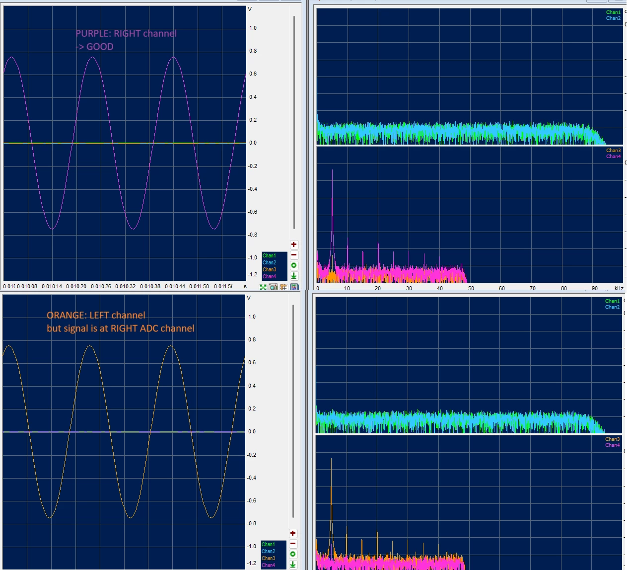

G431 with an audio ADC (TI’s PCM1822) connected to SAI1_Block_A, SAI is in master receiver mode, meaning it provides the I2S clocks for the external ADC.
DMA is used, circular, 32-bit.
Signals looking good at all audio sampling frequencies, up to 192 kHz.
Problem:
always at 1st start, and every now and then after a SAI + DMA stop and restart, somehow the 2 ADC channels are swapped.
I checked all I2S signals with a scope, and data is always where it’s supposed to be.
I can check the DMA buffer, it’s definitely the SAI.
BAD buffer / channels swapped,
signal connected to RIGHT ( = R ) channel only,
so LEFT should be 0
L R L R L R L R
000: +0.31 -0.00 +0.37 +0.00 +0.38 -0.00 +0.36 -0.00
008: +0.30 -0.00 +0.20 -0.00 +0.09 -0.00 -0.04 -0.00
GOOD buffer: L = 0, R = signal
L R L R L R L R
000: +0.00 +0.26 +0.00 +0.16 +0.00 +0.04 -0.00 -0.09
008: +0.00 -0.20 -0.00 -0.30 -0.00 -0.36 +0.00 -0.38
our analyzer:
Here are the DMA + SAI start and stop functions:

LCEBest answer
Principal III
Oct 6, 2026 8:45 AM UTC
Yikes, that was simple…
I somehow assumed that I had not turned the SAI FIFOs on - but they always are.
So, FIFO flush after DMA and SAI stop with: SAI_ADC_12->CR2 |= SAI_xCR2_FFLUSH;
And no more channel swapping.

waclawek.jan
Oct 6, 2026 8:57 AM UTC
I would try to swap the SAI disable and DMA disable, i.e
	/* disable */
SAI_ADC_12->CR1 &= ~SAI_xCR1_SAIEN;
/* wait */
while( (SAI_ADC_12->CR1 & SAI_xCR1_SAIEN) != 0 )
// now disable DMA
SAI_ADC_12->CR1 &= ~SAI_xCR1_DMAEN;
Rationale: I can quite well imagine that after clearing SAIEN, SAI finishes the current frame i.e. it has a word in its data register, which - if DMA is already disabled - remains there and after reenabled, is “spuriously” transferred via DMA before “real” data, spoiling the ordering.
I am speculating here, but you can observe the SAI registers (namely SAI_xSR.FREQ and FLVL, but make sure you don’t read SAI_xDR as that spoils the magic).
Another option might be to try to reset SAI in RCC before restarting.
LCE
LCEAuthor
Principal III
Oct 6, 2026 10:03 AM UTC
​@waclawek.jan I played with the disable order DMA / SAI, found that it was definitely the missing FIFO flush.
Which makes absolutely sense. I must have “dreamed” that there ever was a FIFO enable bit for the SAI. :D
And before disabling the SAI, the SAI’s DMA enable bit is cleared.
