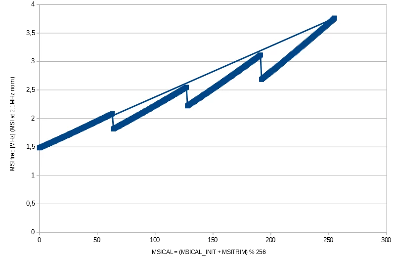

waclawek.jan
Sep 21, 2026 10:59 AM UTC
The step in frequency occurs not when RCC_ICSCR.HSITRIM is multiple of 64, but when RCC_ICSCR.HSICAL (which is (initial/system-memory-stored-HSICAL + HSITRIM) mod 256) is multiple of 64.
waclawek.jan
Sep 21, 2026 11:03 AM UTC
The following graph is from my own characterization of one particular STM32L053 (from a ‘L053 Disco), the oscillator is different, the technology is different, but the principle is similar. Note the changing slope and also the changing step at different (CAL+TRIM) values:
