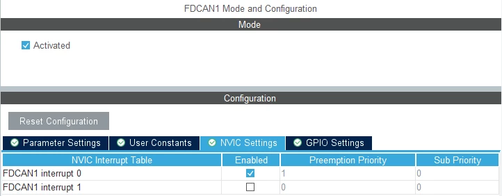

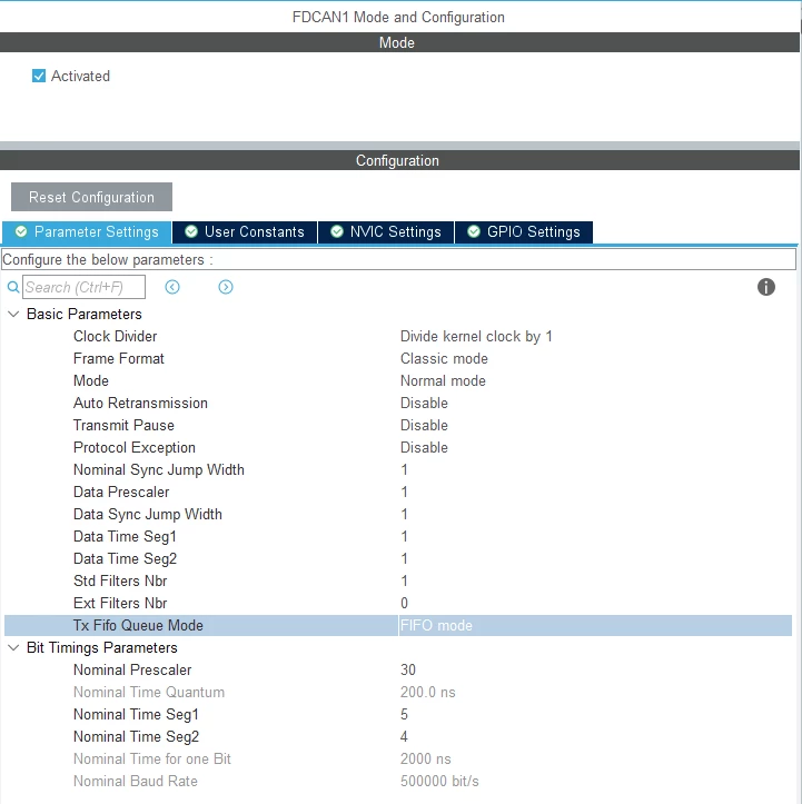

I am using STM32G431KBT MCU. I am using 2 MCU (master / slave) and they communicate via canbus. Canbus is working good but canbus filter is not working. Master canbus address is 0x200 ans slave address is 0x101. I changing master ID (0x150) but the slave still continues to receive data and go to the canbus callback program. Cubemx settings are as follows;

I tried the every filter type (mask, dual, range) but Canbus filter is doesn't work and accepts all addresses. I am watching RxHeader in debug watch. RxHeader.Identifier is 0x00000150 and program goes to HAL_FDCAN_RxFifo0Callback with every new message. Whats is the problem?

1 - There is no Master-Slave concept in CAN bus all nodes have the same privilege.
2-  You forgot to call HAL_FDCAN_ConfigGlobalFilter() after the filter config:
 if (HAL_FDCAN_ConfigGlobalFilter(&hfdcan1, FDCAN_REJECT, FDCAN_REJECT, FDCAN_FILTER_REMOTE, FDCAN_FILTER_REMOTE) != HAL_OK)
 Error_Handler();
3- To receive only the ID 0x101:
 sFilterConfig.FilterType = FDCAN_FILTER_MASK;
 sFilterConfig.FilterID1 = 0x101;
 sFilterConfig.FilterID2 = 0x7FF;
  Hope that helps.

I know how canbus works. In my previous experiments, I used 2 MCUs. That's why I didn't need filtering. However, in the project I'm working on, 1 MCU communicates with 20 MCUs over the canbus line and sends the data it collects to the PC via UART. The other MCUs only need to process the data coming from the MCU that communicates with the PC. That's why filtering is very important in this project. That's why I used the terms master and slave.
I was beginning to think that there was a bug in cubemx or the HAL libraries, so I manually added the following lines to the program. It worked when I added these lines.
 volatile uint32_t *rxgfc = (volatile uint32_t *)(0x40006400 + 0x0080); // 0x40006480
 *rxgfc = (1 << 5) | (1 << 16); // F0OM = 1, ANFS = 2, LSS = 1
But I missed the "HAL_FDCAN_ConfigGlobalFilter".Thanks @mƎALLEm, It's working.
