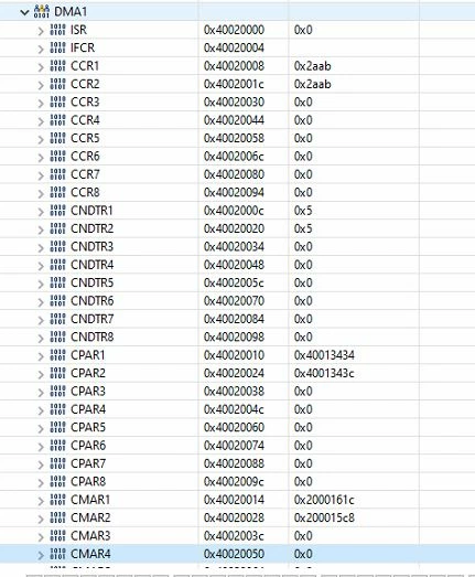

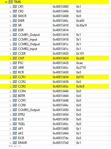

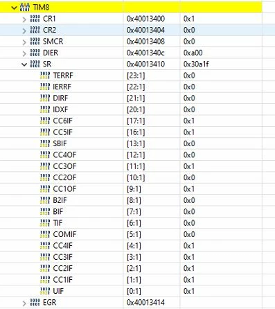

Here is an update. In debug mode I am running a 200Hz logic signal into PC6 for TIM8_CH1 and internally in the main while() loop I am executing TIM8->EGR = TIM_EGR_CC3G  every 500ms. In the TIM8 registers I can see that CCR1 and CCR3 are getting loaded and the CC1F and CC3F flags are getting set. However, the ISR for DMA1_Channel1 and DMA1_Channel2 are not getting executed.
Am I correct that this seems to rule out TIM8 as the problem and my problem is somewhere in the DMA peripheral setup? I've collected the readings for registers DMA1 and DMAMUX and starting to analyze those to make sure I set up the DMA correctly.

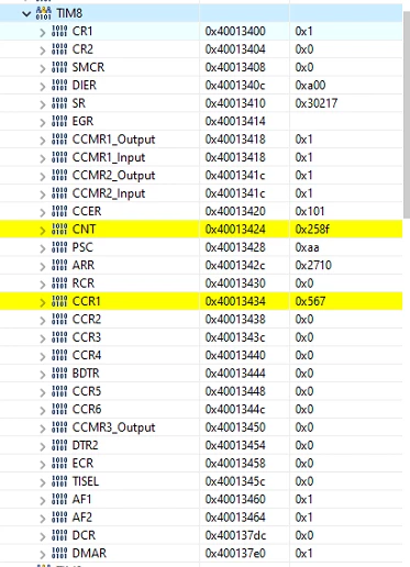

Another update and a request for help! I have had no responses.
I have looked at examples and have read the ref manual and the book "Mastering STM32" and can not track down my problem.
Succinctly, TIM8 flags CC1F and CC3F are getting set but the IRQ for DMA1_Channel1 and DMA1_Channel2 is not getting executed.
DMA is set-up, clocks are enabled, DIER is set and I started both channels using HAL_DMA_Start_IT()

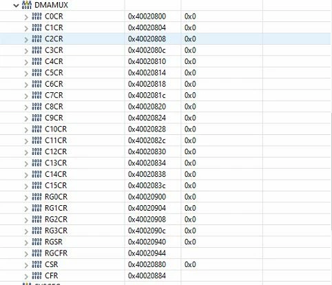

I am including snapshots of the TIM8 reg, DMA1 reg and DMAMUX reg,

May 4, 2021 5:23 PM UTC
All DMAMUX registers are 0, it means that there's no routing set up there from TIM to DMA.

That lack of routing certainly does explain my problem. In the past when I set up DMA on this same device I don't recall having specific commands to set up DMAMUX?
I thought if I had the DMA set up with:
hdma_tim8_ch1.Instance = DMA1_Channel1;
along with other configuration settings and used HAL_DMA_Init() followed by using HAL_DMA_Start_IT() it would be set up.
Is there an explanation or examples how to set up DMAMUX using either HAL or LL ?
I don't use Cube, but for simple routing, as is your case, it's enough to set the source number into the respective DMAMUX_CxCR.DMAREQ_ID - see DMAMUX chapter, for numbering of sources see the DMAMUX: assignment of multiplexer inputs to resources table at the beginning of that channel.
There's one gotcha - DMA channels numbering starts at 1 while DMAMUX channels are numbered starting at 0, so DMA1_Channel1 is set in DMAMUX_C0CR. Unfortunately, the way how these registers are defined in the CMSIS-mandated is extraordinarily idiotic, so you have to use something like DMAMUX1_Channel0->CCR.

Thank you so much for the valuable info!! I was not setting up the DMAMUX, not realizing it was needed. After setting up the peripheral and the DMA channels I for now added these two lines:
/** setup the DMAMUX **/
LL_DMAMUX_SetRequestID(DMAMUX1, 0, LL_DMAMUX_REQ_TIM8_CH1);  // #49
LL_DMAMUX_SetRequestID(DMAMUX1, 1, LL_DMAMUX_REQ_TIM8_CH3);  // #51
The code now executes the IRQ for DMA1_Channel1 and DMA1_Channel2 in response to TIM8_CH1 and TIM8_CH3
I think my log jam is unblocked for now.
