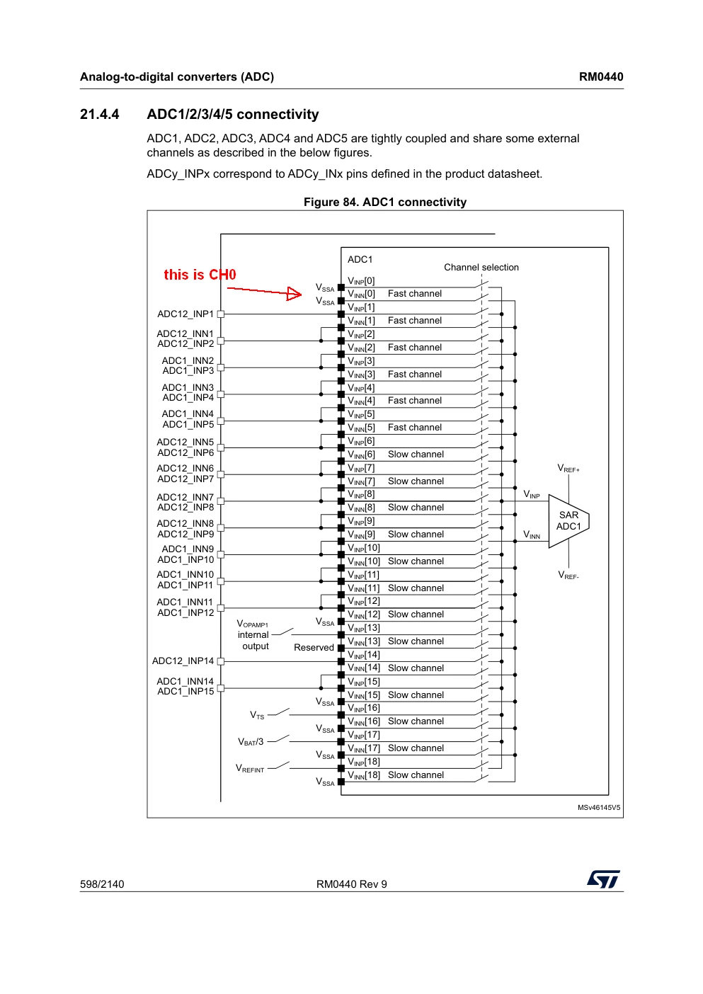

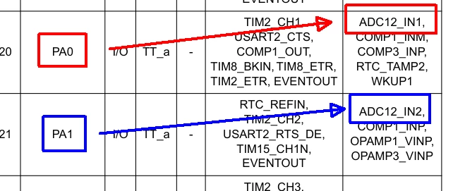

Heyho,
I’m confused - or the STM32G431KBU (in QFN32) is…
I’m using ADC 1 with 2 external inputs, PA0, PA1, and the internal “REFI” and temperature channel “TEMP”.
All running with continuous and circular DMA in the background, no interrupts. If I need an ADC value, I simply grab it from the ADC DMA buffer.
This is basically working, except for the channel sequence. Which I set manually, but have at least triple-checked the SQR1 / SQR2 values with the RM...
If I set up the channel sequence in ADC1->SQR1 in the order: PA0, PA1, REFI, TEMP, then I find in the DMA buffer instead of this order: 0, PA0, REFI, TEMP
→ so PA0 was “shifted”, PA1 is nowhere to be found (it is not 0, checked the GPIO via scope).
If I add and insert a dummy channel “VDMY” as the first in the sequence, so that the sequence should result in VDMY, PA0, PA1, REFI, TEMP, I find this order in the DMA buffer:
PA1, VDMY, PA0, REFI, TEMP
At least I get all the channels now, the measurement data is correct.
So, what am I messing up in the ADC & DMA setup?
Something in the init sequence concerning DMA / ADC ?

VDMY PA0 PA1 REFI TEMP <- that' what it should be, but it is:
PA1 VDMY PA0 REFI TEMP

* PA0 ------> "ADM_IN0" in schematic
* -> VPWR = ~ 5V, divider 47k / 22k
* PA1 ------> "ADM_IN1" in schematic
* -> VRECT = ~ 6V..12V, divider 47k / 10k

waclawek.jan
waclawek.janBest answer
Sep 24, 2026 9:24 AM UTC
Thanks for coming back with the solution.
It kinda *is* documented, both in DS and RM; but I agree that it *is* confusing.

Got it!
And as almost always, it was a simple thing:
I checked the HAL definitions (using like a 100 other definitions, incl. LL_) and found that when using “PA0” as external ADC input, the internal channel number is not 0, but 1. And accordingly PA1 → channel 2.
I cannot find any such hint in the DS or RM, this should be documented more clearly somewhere in the RM.
Thanks to all for having a look at it!
