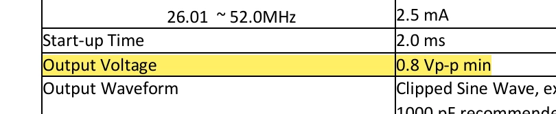

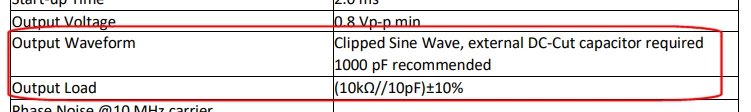

I use FT2MN at 40 MHz. Its output was connected through a 10 pF capacitor and a 220 Ohm resistor, in series
Please show the actual schematic - far better than trying to describe connections in words.
But it doesn't sound at all like what the datasheet recommends:
September 20, 2024
0.8 Vpp isn't sufficient for the incoming clock signal to the STM32F4.
Should be able to find a different part that outputs a clock with 3.3V logic.

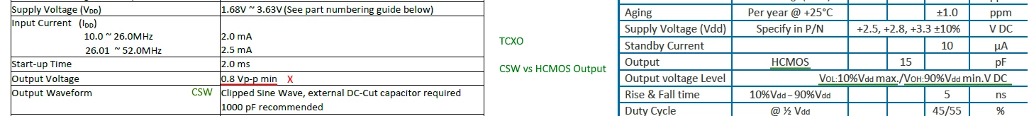

In this case, it was my mistake with the choice of the generator. I mistakenly perceived 0.8 Vp-p as 0.8 V from the supply voltage of the generator. But it is not so. This is exactly 0.8 Vpp (peak to peak). Abrakon recommended using generators with HСМОS output.
They have a slightly lower accuracy and more consumption, but the output voltage meets the requirements of the STM32 datasheet.
Below is an excerpt from two datasheets of the CSW generator and the HCMOS. I hope this will help you not to repeat my mistakes.
