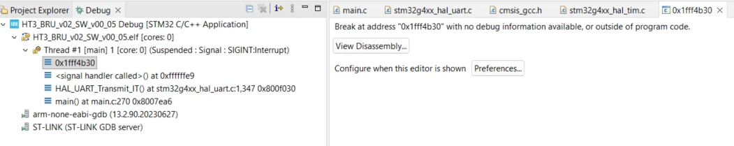

Here’s an image of where the program points at when I press stop on the debugger after an interrupt call

I think there is too little context to identify the issue immediately, but the crucial interrupt handler code is missing.
Have you checked you handled all interrupt causes, including (UART) error interrupts. TxE and RxNE are cleared with accessing TDR, but other flags (like error interrupt flags) must be reset explicitely. Otherwise the core will immediately reenter the handler.
Second, make sure no other interrupt takes precedence and causes “overflows” in the UART handler.
Your image suggests the TxE interrupt is responsible for this effect.
I hope you are aware that you need to disable the TxE interrupt when writing the last byte of a “string” to TDR.
I use to do that in the TxE section of the handler itself, directly before writing this last byte.

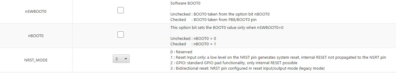

​@db16122  Version A and version B are two different design. The only differences are the power rail the signals connected to pin PB6, PB7 have been swapped. The component placement and traces layout changes aswell.
​@waclawek.jan VTOR=0, but the option byte are set so that the boot0 pin is ignored (nSWBOOT0 = 0, nBOOT0 = 0) I also tried enabling the internal pull down, but nothing changed. What’s weird is that VTOR=0 in version A aswell, but this board works fine

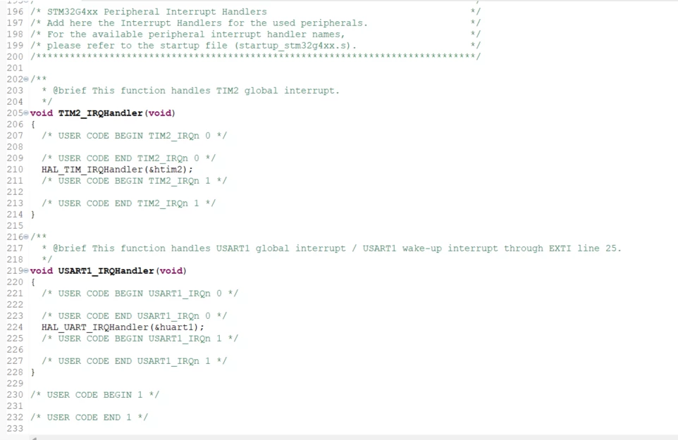

​@Ozone I created a simplified version of the program that I’m attaching here (test_easy.zip).
When adding a breakpoint at line 220 the program never reaches it. It gets stuck before calling the interrupt callback
As a reminder this isn’t linked to a specific interrupt. I tried removing the UART communication and the program gets stuck as soon as TIM2’s interrupt fires.
I think you misinterpret the messages by the debugger as shown in your first post.
I very rarely worked with (directlx) GDB-based debuggers lately, but this tool comes from the Unix/Linux world.
And the term “signal handler” does not refer to interrupts in this context, but to other events like access violations or abort requests.
I think you run into a fault handler from within your UART transmit handler routine.
