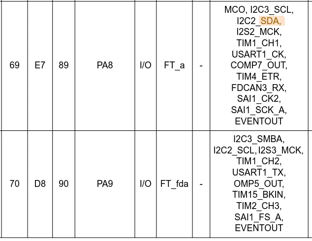

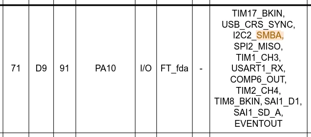

I just noticed the following:
In the datasheets for the G473 and G483 the pin table and alternate function table disagree which pin has the I2C2_SMBA and I2C2_SDA function.
The pin table claims PA10 is I2C2_SMBA and PA8 is I2C2_SDA. The alternate function table claims PA8 is I2C2_SMBA and PA10 is I2C2_SDA.
From experiments it seems the pin table is correct.
Can someone confirm which is the correct alternate function?
Now that I was comparing both columns: it also seems I2C3_SCL is placed differently in both tables: the pin table has it on PA8, the alternate function table on PA10.

Hello @Loebl ,
Thank you for bringing this issue to our attention.
I confirm the issue and I reported internally.
Internal ticket number: 137961 (This is an internal tracking number and is not accessible or usable by customers).
Foued

Hello @Loebl
I confirm the problem of  I2C2_SDA and I2C2_SMBA in the G483. But  G473, this problem doesn't exist.
For the I2C3_SCL problem, I can confirm it for both G4 models.
Best regards.
