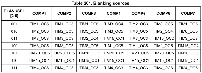

STM32G4 reference manual is missing comparator blanking select disable setting
  • June 15, 2026
  • 1 reply
  • 41 views
In the reference manual RM0440 Rev9 of STM32G4 family the bit combination 0b000 for the BLANKSEL setting in the comparator registers COMP_CxCSR is not documented:
(Screenshot of page 771 and 773)
I assume 0b000 means blanking input disabled, but it should be written in the rm.

Hello ​@tdecker2 ;
Thank you for bringing this issue to our attention.
I reported this internally for checking and fixing.
Internal ticket number CDM0063527 (This is an internal tracking number and is not accessible or usable by customers).
