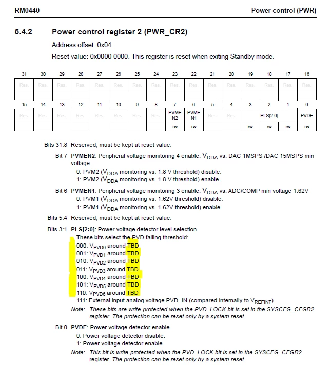

STM32G4 PVD detector levels/thresholds not specified in RM0440 Rev2
the meaning of the PLS[2:0] bits in the PWR_CR2 register is not yet documented in the RM0440 Rev2, they're marked "TBD" (see screenshot attached). Could you provide the mapping of thresholds levels?
Thanks a lot!

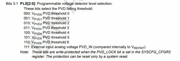

Hello @MScho.1​ ,
This is already updated in new RM0440 (draft) which will be available soon on ST web site.

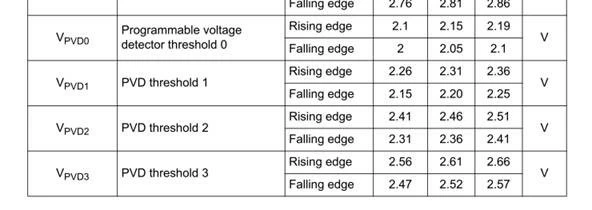

thanks. In the meantime I found out that the real voltage levels (what I was interested in) are given in the datasheet in section 5.3.3. A reference in the RM to the datasheet could also be useful for others looking for those values.

Mar 30, 2020 11:26 PM UTC
Yes, this is true. The mentioned “PVD threshold X�? are in datasheet. The reference manual should have minimum numeric values.

Apr 27, 2020 11:52 AM UTC
I would inform you that the RM0440 Rev 4 is available on ST website with update.
