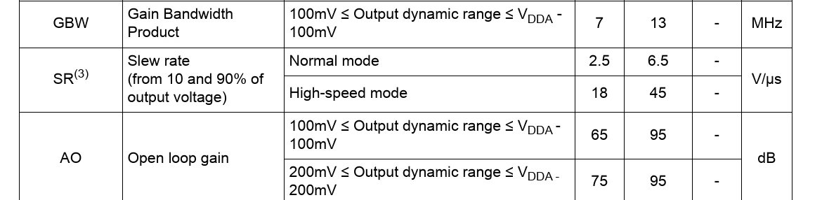

Is there a spice model for these op amps?  I am using a stm32g474ce.

Hello @Repwoc
The CAD Ressources of the STM32G474CE are available on this link. For the Operational amplifier only, there is no CAD Ressources available for any of the MCU internal components.

afaik - no.
But you could use standard opamp model just setting its parameters as given in ds ->
The parameters depend on the setting you choose for the opamp.
Then you can simulate with the opamp, as you set it.

OK, thank you.  I will try to figure out how to do that.
