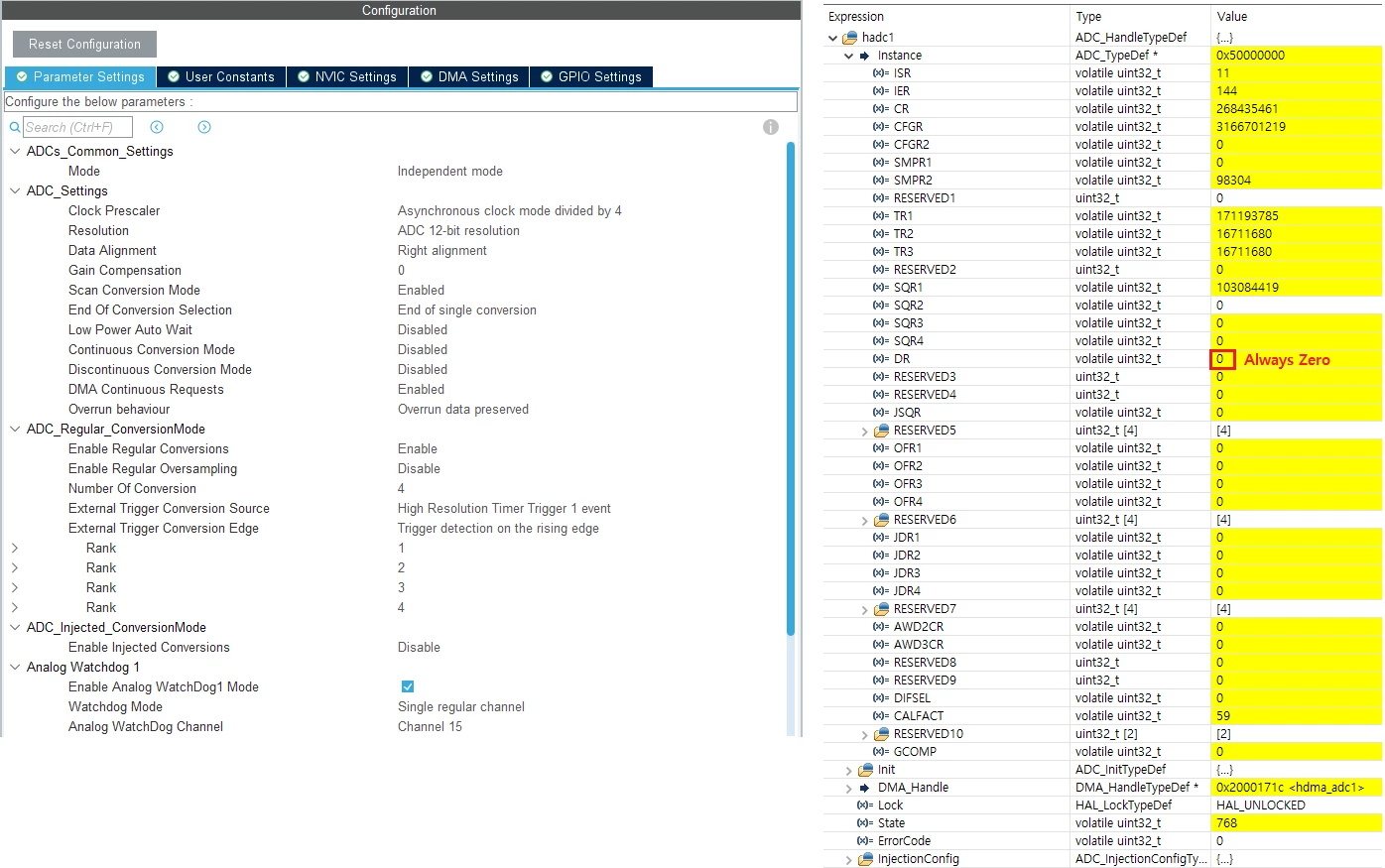

I'm using an STM32G474ME MCU for grid connected power converter applications.
I use multiple ADC modules for current and voltage sensing of the converter, and when I drive the power converter, the result values ​​of all channels in certain ADC module are fixed to zero. The strange thing is that when it is fixed to 0, no ADC error occurs, and only the DR register value is fixed to zero.
I am currently using ADC modules 1 to 5, and each module has 3 channels. The ADC starts by triggering the HRTIM interrupt, and the converted data is saved as an array using DMA. To help you understand, I have attached the Cube MX settings and registers of ADC module whose output(DR) is stucked to zero.
What could be causing this problem? Could this phenomenon be caused by EMI due to the switching of the power converter?

  Hello wronskian,
Yes - this phenomenon is caused by the EMI. Please check your PCB design. Usually the ADC is stucked to one fixed value if the difference between VSS and VSSA is more than allowed 50mV (even in a short peak caused by some transient effect from your power converter).
 To avoid this we should carefully design PCB to avoid digital and analog grounds differences and also some another disturbance.
  In current design : the only solution (without need of power off / on the application) is to disable the ADC and then reinitialize ADC again. By disabling the ADC, ADC is completely unpowered internally which allows to jump out from the "locked" state caused by the EMI pulse. Better solution is to avoid this state by proper PCB design.
